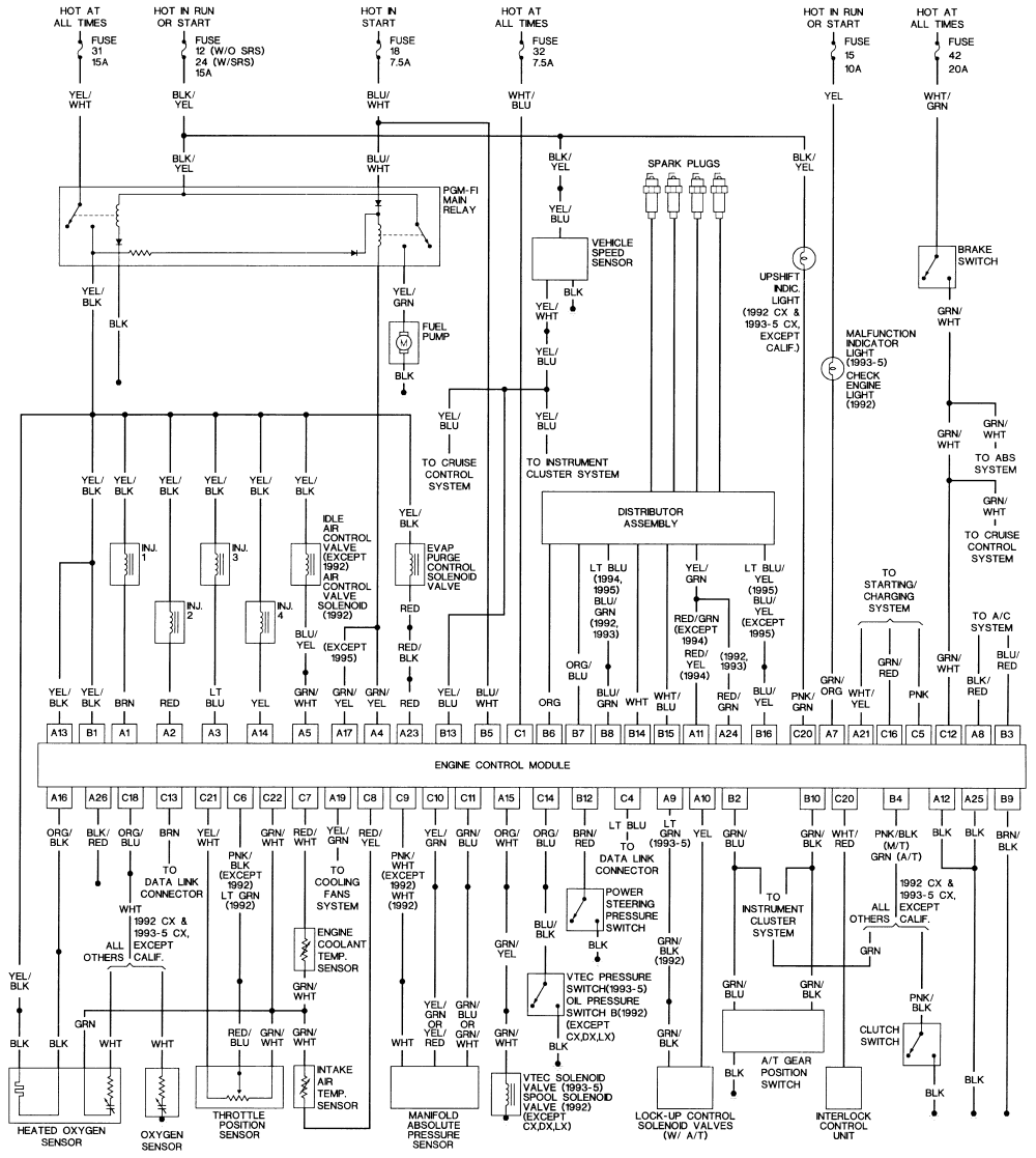

Check wire continuity between ECM and distributor.
From Autozone website: http://www.autozone.com/repairinfo/r...00c15280061b0f
