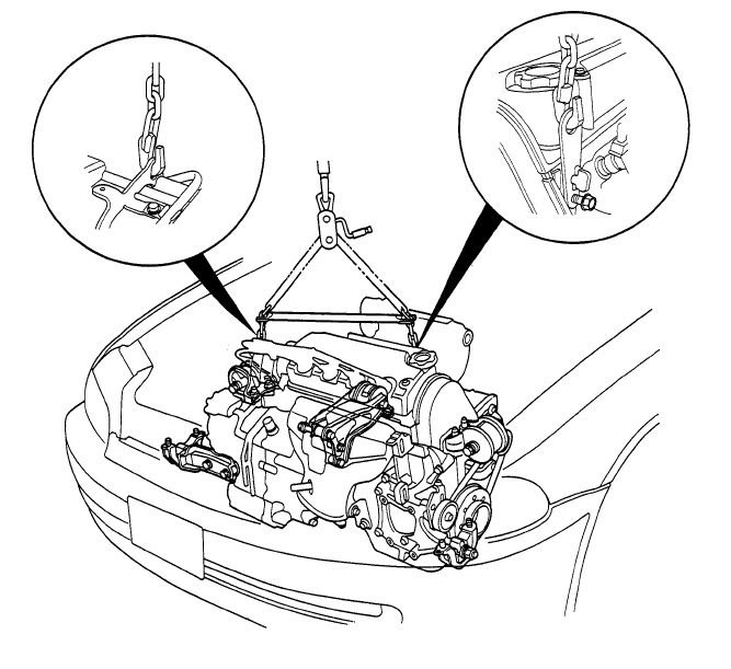

Pulling out a d16 out of a 95 civic with trans and was wondering where to hook up the chains if anyone ever did this. Pics would help. Thanks guys!

Remove as much dead weight from the engine as possible.
You can also use the p/s steering mounting holes as another point as well. I've also seen people wrap the left side around the distributor but that is way to dangerous because of the weight of the transmission on that side.

P/S BRACKET SOUNDS GOOD TO ME!.
