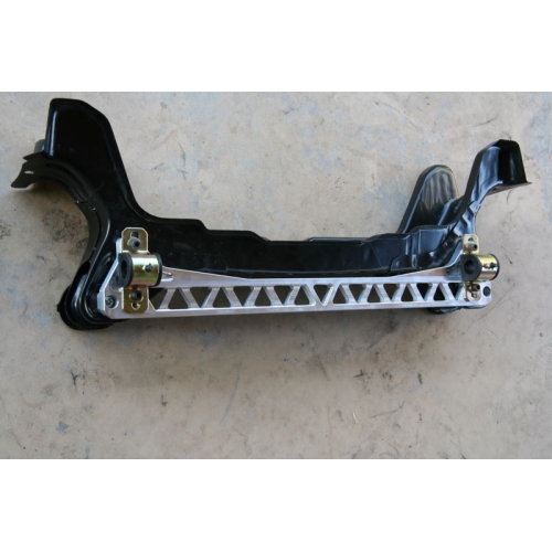

Old 01-19-2013, 07:38 AM
jbpnoman's Avatar
Join Date: Feb 2008
Location: Charlottesville, VA, USA
Posts: 6,420
Received 5 Likes on 5 Posts
Default Re: Hit curb, bent control arm bridge. Anyone know how to fix this problem?
Are you talking about this part? I mean the black part, not the F7 brace attached to it.

I managed to find it in the OEM schematic, assuming that's the part you're talking about.
50200-S04-A02 001 001 BEAM, RR. 589.58 412.71
It should (assuming I'm looking at the schematic correctly) be held in by 12 bolts. The image shows it in the front, but it's listed under Civic - [year] - [trim] - [engine/transmission] - REAR BEAM

^ That's the front subframe. Honda calls it the rear beam for whatever reason, presumably because it's behind the engine.
Well ****, I tried
Is the first image I posted the rear, or is that still the front rear?
