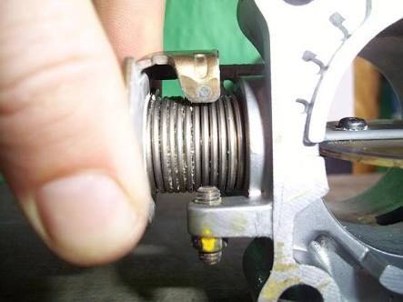

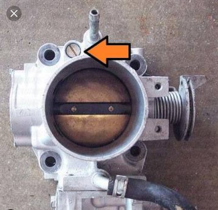

Old 08-21-2017, 12:09 AM
Join Date: Aug 2017
Default Re: High idle at startup. Gone after restart
yes i found the CULPRIT !!!
You are the culprit , not the car n its systems definitely
We as humans think we are smart than car , but we forget that car works on a defined set of commands and protocols which is commanded by ECU .
by disconnecting the MAP sensor you are doing nothing just giving a message to ECU that something is wrong with the electronics of car , and ECU adjusts itself to the situation by not using the data coming from sensors , and using a average value which ,which temporarily solves the issue of rough/irratic idle , but this is not the solution!!
What you actually have to do is let the car decide and adjusts its values acc to the situation( temperature,altitude,load) it is in !
1. Disconnect the negative point of battery
2. Disconnect all sensors on throttle body ( MAP, TPS, IACV)
3. remove throttle body
4. Remove IACV( idle air control valve)
5. Clean it with a carb cleaner or throttle body cleaner or alcohol.
6. reinstall the valve
7.reinstall the throttle body
8. ADJUST THE SCREW WHICH IS LOCATED ON RIGHT JUST UNDER WHERE THE THROTTLE CABLE CONNECTS TO THE THROTTLE BUTTERFLY VALVE ( DO NOT TRY TO ADJUST THE RPM OF ENGINE WITH THIS SCREW, IT IS JUST FOR PREVENTING THE BUTTERFLY VALVE FROM STICKING INSIDE THE THROTTLE BODY BORE)
9. tighten the air screw completly (placed on top right of throttle body)
10. Connect all the hoses you disconnected.
11.check all the hoses and connectors once again.
12. Connect the negative terminal of battery
13. Now start the engine without a/c ( for about 4-5mins) ECU will relearn its idle acc to load ,temp. And altitude
The real problem is when we try to adjust idle of car we do alot of thing ,diffrent people and their diffrent techniques and we end up messing with our car
We adjust idle with either air screw or butterfly valve anti-stick screw, so idle increases. And car cannot check the position of screws electronically ,so it gets confused.and can't figure out the source of extra air coming in and tries to componsate for it by decreasing the amount of air passing throung IACV. Then ECU realize that the new adjusted value of IACV is lower than the min. Value needed, so it increases it again.
this cycle of idle increase and decrease continues.
AND THE RESULT IS IRRATIC IDLE.
AND THEN WE TRY A BUNCH OF DIFFRENT THING TO MAKE IT RIGHT .

Old 08-28-2017, 03:10 AM
Join Date: Dec 2010
Posts: 3
ok....so i did try a fiends map sensor ...and i have the same issue ....
i will try to do the steps you wrote ....here.
thank you
