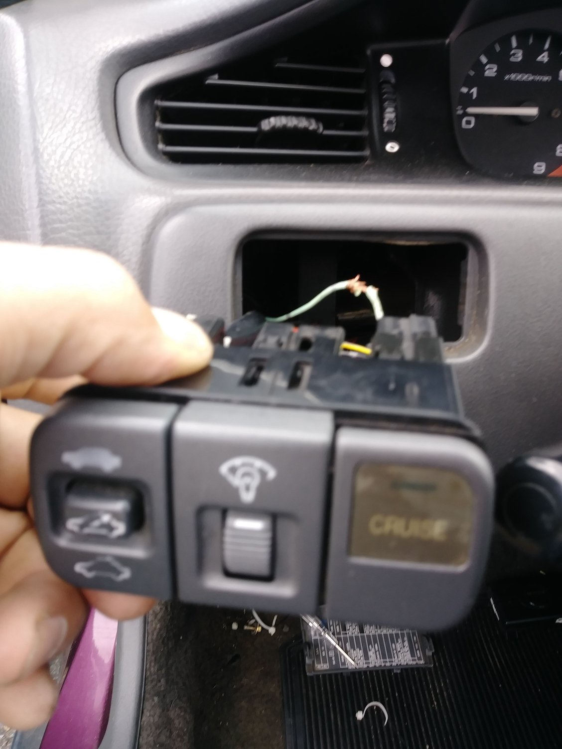

so my issue is my car wont start. It all started when i tried to hook up my fogg lights to the cruise control button . now even the green light on the button doesnt even light up either.. I hooked it up here because i dont have cruise control on my car. Little would i know that it would cause my car to shut down on me 2 blocks down from my house. The check engine light stays on and so does the red oil light. Prior to this happening the car was fine no problems what so ever. On the dash my srs light was on too and when it shut down on me that also turned off.
ive checked all fuses and they are all ok.
No green light?
This is where i had ran a wire to my fogg lights.
No cruise control.

What made you think that was a good idea? What knowledge of electrical do you have? Do you know where that green wire goes by looking at an electrical diagram or are you just guessing?

I have no real electrical experience i just figured since it wasnt being used id run a wire to that switch to power on my fogg lights . guess it was a bad idea.. Any help is appreciated. I need this car running as soon as possible . its my daily for work and back.

I am guessing that you blew fuse 24 in the SRS fuse block, and hopefully nothing worse.
Conceivably, this experiment would have worked if you knew what you were doing. But it would have involved disconnecting all the other connections related to the cruise control.
DOWNLOAD THE SERVICE MANUAL BEFORE YOU DO ANY MORE EXPERIMENTING. THEN READ AND UNDERSTAND WHAT YOU ARE DOING BEFORE DOING ANY MORE EXPERIMENTING.
Disconnect all that **** first, before replacing the fuse, for one. And only replace it with the CORRECT FUSE RATING! (15A for fuse 24, fyi)
Let this be a learning moment.
I swear it's this kind of "I'll just do this, what could go wrong?" attitude that winds up giving us asinine warnings on everyday objects: "Caution: Contents Might Be Hot" on coffee cups, being a prime example.
Do you think NASA just eyeballs **** before they send someone into space? (Just in case, the answer is NO.) Since this is your chariot to and from work and needs to be just as reliable and a ******* NASA rocket, understand what you are doing before doing it. If your teachers in school didn't drill this in to you, then let a random person on the internet convey the importance of this instead.
