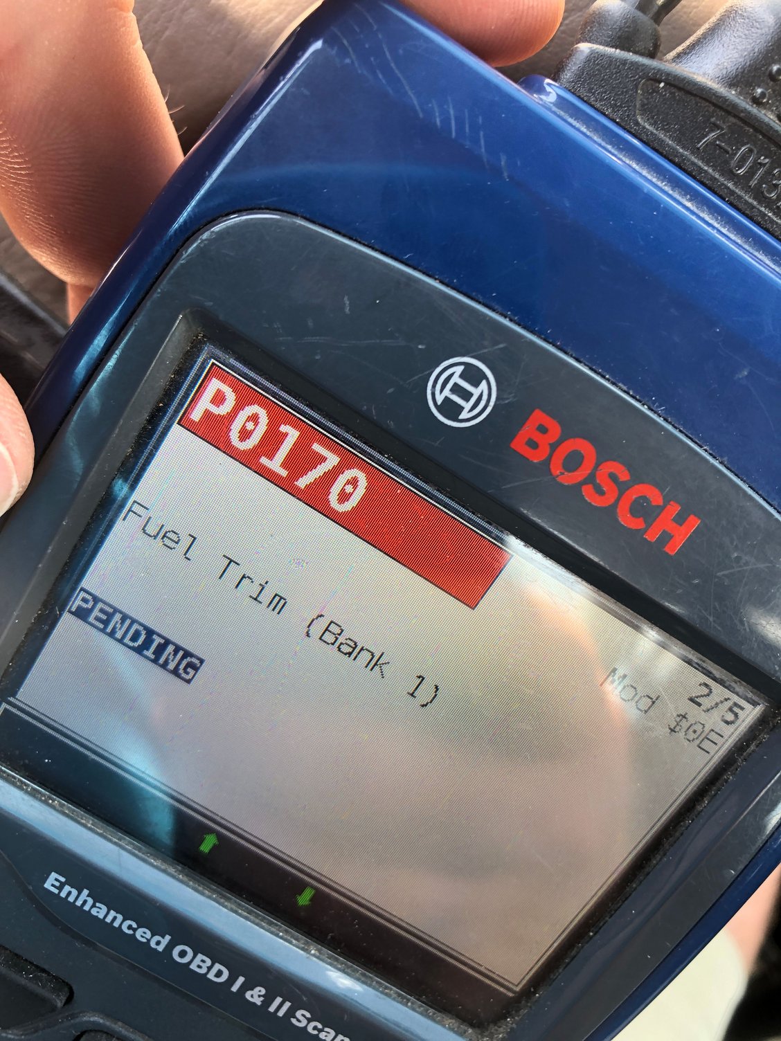

Also p0170 maybe?
P0170 indicates an unspecified fuel system problem. P0172 specifies the fuel system problem - running rich.

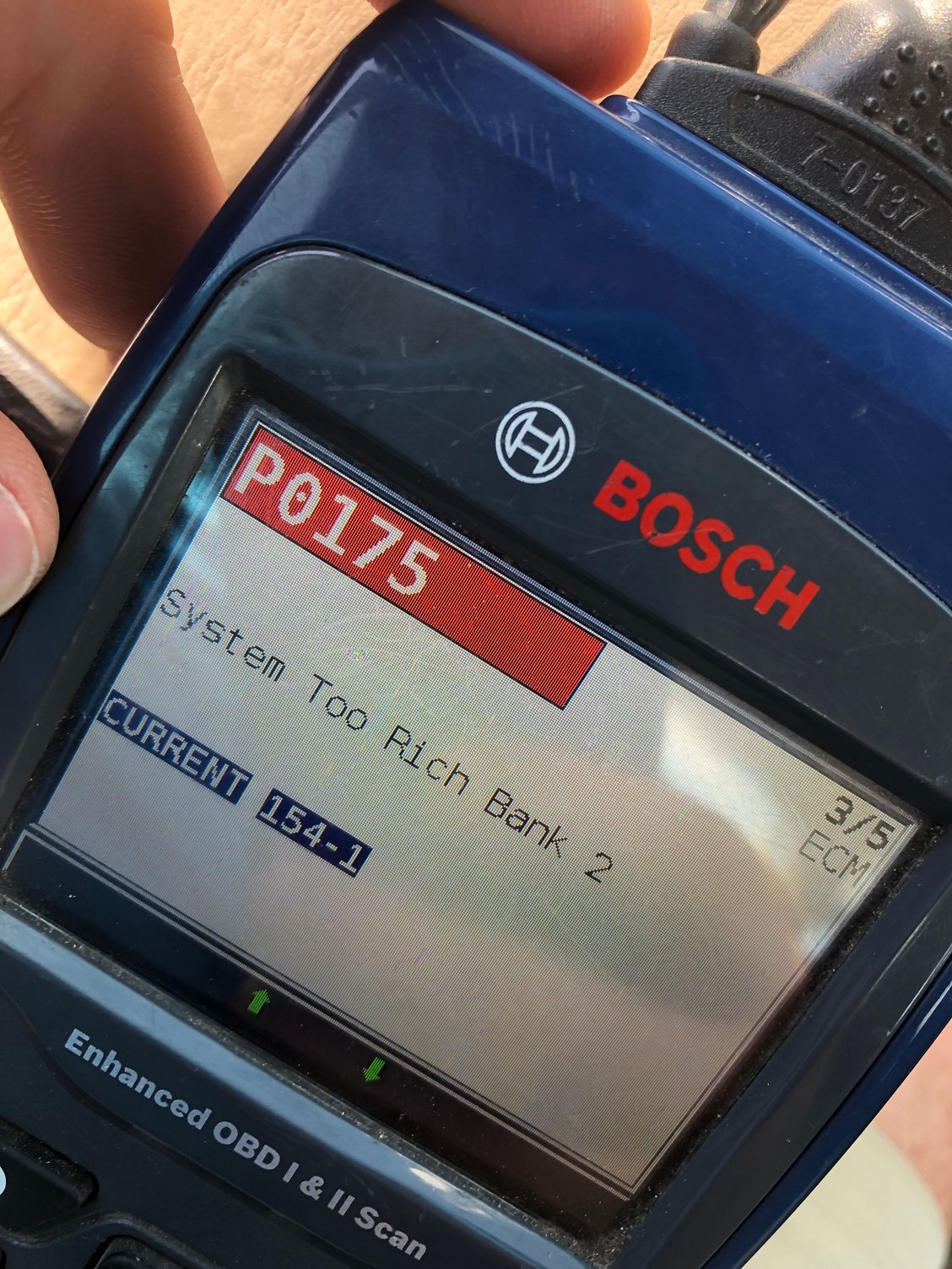

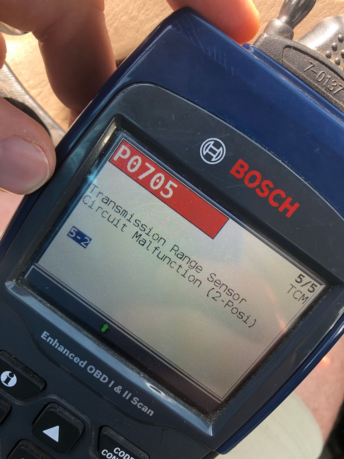

I took pics of all the codes I received. See attached.

Code readers are designed to pull trouble codes from many different car makes and models. This is great, but an accompanying problem is that code readers also commonly spit out a lot of red herrings (junk information).
The OP's last post reveals four current CEL codes -- P0172, P0170, P0175, P0705. Three of the latter codes are completely redundant (P0172, P0170, and P0175) because they report the same fuel trim fault.
Only one of the codes is used by 96-00 Honda Civic ECU -- P0172. Consequently, you will find detailed troubleshooting for this code in the 96-00 Honda Civic service manual.
P0705 suggests an automatic transmission sensor fault. To identify this potential fault, the OP would need to short the service connector and watch the D4 light in the cluster blink the transmission code (numbers in parentheses in table below).

P0175 = P0172
...so I think here^ you mean P0705 not P0175. Jumping the service connector is a simple process.
