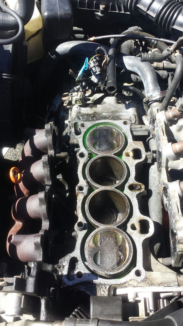

here is the block/pistons in the car

By the looks of the black specs on the block, it's the original graphite gasket. You will want minimum 1000 grit 3m wet sand paper to wet sand off the graphite gasket, don't use a metal razor blade.
You will want new head bolts being you have the old set and it's not recommended in the TSB for the new head gasket. There is a replacement gasket for non vtec motors that leak. I would switch to that gasket regardless as it is the proper thickness MLS gasket.

As for doing the rings... I wouldn't touch them. Feel the top edge of each cylinder and see if you feel a ridge. If you do, you will need a bore and hone for new rings which also means new pistons as the piston to wall clearance will be out of spec from the bore and hone. Anyway you look at it, to do rings you have to do more than just drop the oil pan and oil pump, you have to remove the crank and that means removing the engine block from the car.
To see if you need to worry about that, you can lower each piston down and visually inspect the cylinder walls. If there is no gouging, and you can see remnants of the original hone cross hatching you don't need to touch your rings. If you have any scratches/gouges in the walls you have to rebuild the bottom end with bore/hone, re-ring and new pistons. It's a lot of work and a lot of expensive tools to do it right.
I suspect your pistons are fine and if you aren't knocking then your bearings are still quite likely fine.
But in reality, without tearing it apart and measuring everything with micrometers and dial bore gauges, you don't really know if you are still in spec and fine.
