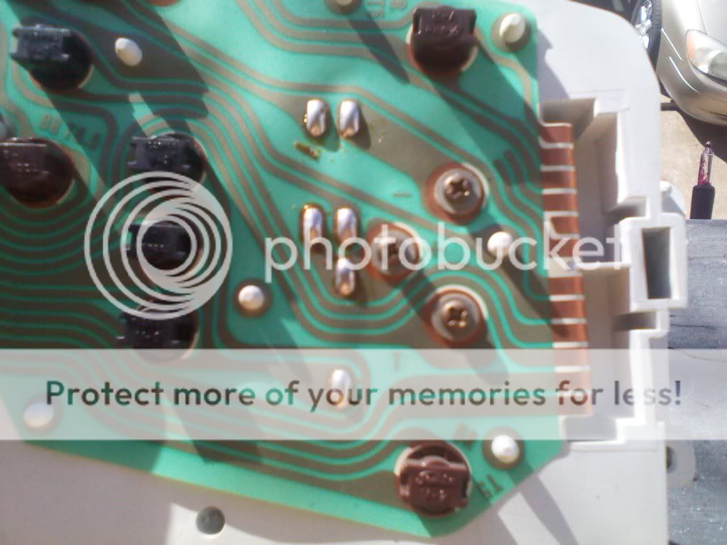

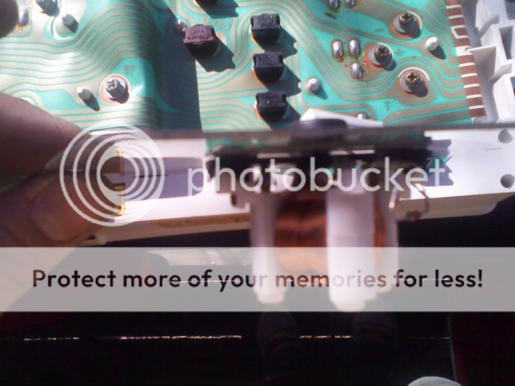

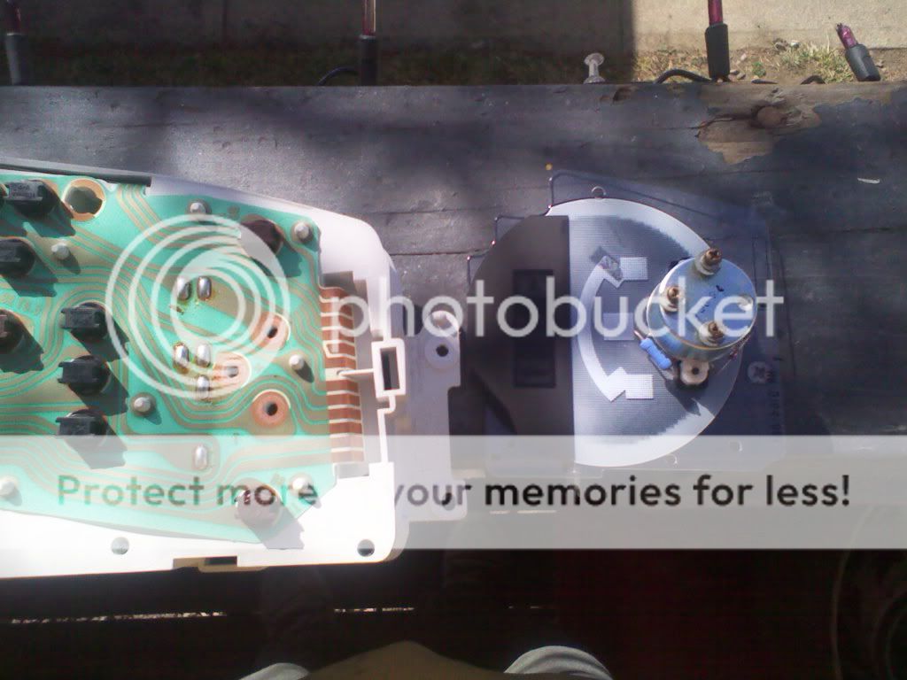

no problem, i have pics of a dx cluster but i am sure they all work the same and you do not want to over tighten the screw on any cluster lol
First you want to take off the screws to the gauge that has been broken due to over tightening.
second you need to remove the gauge and pull it out, now you can remove the metal case that is around the copper wire, you can see what it should look like in the next pic
now that you have it all apart you can take a look at it and if its broke you would see a crack or split in the plastic that the screws go into, if its cracked then more then likely the copper wire has broke off the metal from over tightening all you need to do is find the broken wire and reconnect it with a piece of extra wire you have around just strip the wire down were you can just have a single strand of copper wire next get out the soldier iron and soldier the two ends that have broke and your all done just put everything back together and your done
i dont have a pic of the repair but if you need any help or have any more questions im here to help and return the favor just send me a msg. or post , sorry it took so long to post this but i have been pretty sick trying to pass some kidney stones man there no joke lol
