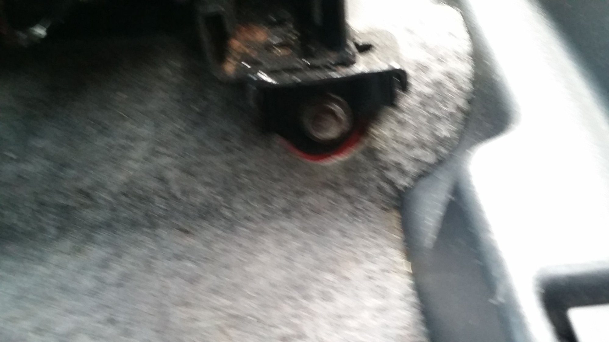

Hey guys I know there's a thread about the rsx seats going into the ek's but the pictures are not coming up in the thread. Just want to know if I'm doing this right. I have the right seat some what in but not really sure how to the right rear braket on. I have it cut off and I think I might put the ek braket on and weld a flat seal to the rail.

if you have access to a welder, this is what I did. The two notches with a 1 inch separation. drill out the rivet holding the bracket, line up the top and bottom notches and the bottom slide it about 1/8" or 1/4" forward so it doesn't fit too tight weld it back in. for the other side you need to make a bracket. just make it long enough so the rear hole lines up with its corresponding hole. by doing this you will make it look like it was factory. Before welding the bracket on the other side, slide the seat back and forth and lock it in place. make sure both rails lock in place at the same time.

Could I use the stock braket that's bolts to the floor weld that to a flat steel and weld that to the rail?
I can send a pic what I mean when I get home

Would something like this work?

Pretty ****** thick, don't you think.

Yeah I know but it's the only thing I have laying around also I want it to be safe

My memory is pretty bad. I dont remember exactly how the original brackets are on the civic and on the acura. But what you just mentioned is what I would try first.
Here is what mine look like on the driver's seat. And it is possible that what you just mentioned is what I did in the front outer side on both seats.

Alright thanks man. I was going to try welding the stock braket to the rail and see how that goes I just don't have time to tear apart the seats and test fit it
