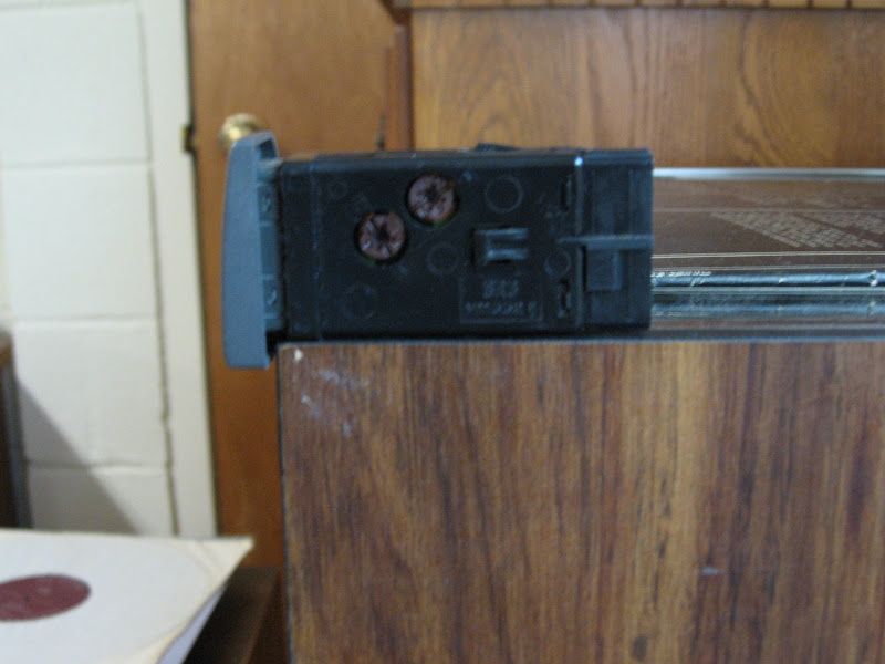

Note: For optical clarity, I used spare parts I had around. The only difference between the pictures and your vehicle is the absence of a dash board and wiring. It should go without saying, but please remember to unclip the wires from the switch before you attempt to remove the switch from the holder.
As seen on a 1994 Civic Ex Ė
Tools/Parts

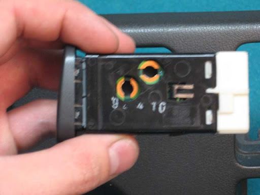

Removal:

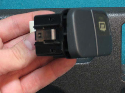

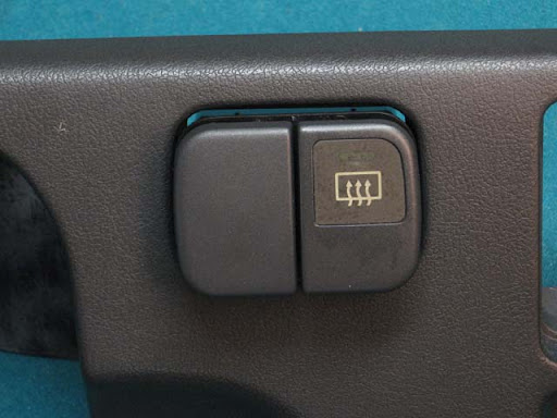

First off, determine what needs to be removed. Rear defroster is most common, since most all cars have it. So, Iíll start with that.
The principle here is simple. You just pry the switch out. Iíll go ahead and make it look easy:
Then unclip the wire from the switch and youíre good to go.

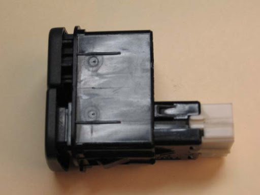

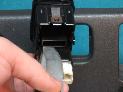

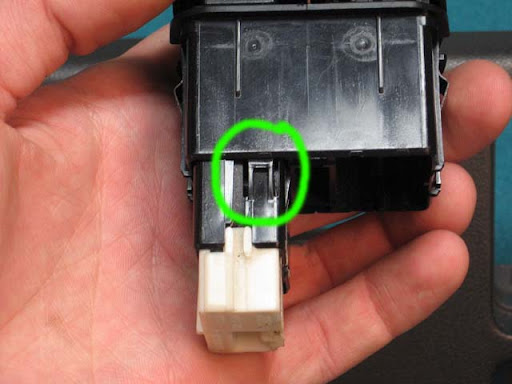

But wait, you say. I tried that, and it didnít want to come out. Thereís a reason why. Honda didnít want you to pull your switch out. The trick is to know where to pry at. There are two metal tabs with a flat spot. The plastic holder is cut out so you can slip something in and push down on the clip. Iíve never been able to get directly at the clip, but if you know where youíre aiming, you can hit the plastic housing and pry against it. Be careful not to damage your bezel or switch.

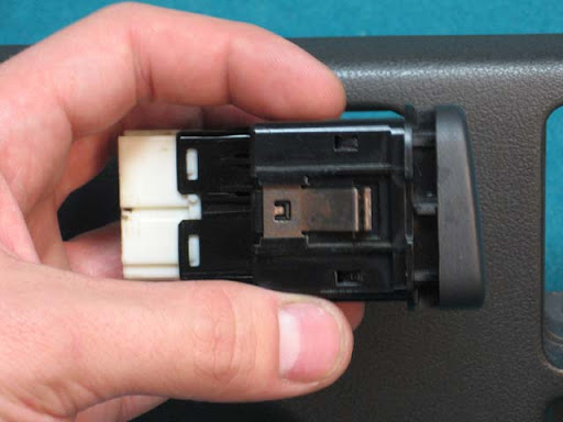

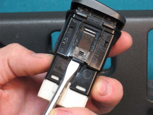

Once the switch holder is out, you have to get the switch out of the holder. There are 4 clips holding the switch in. You have to press on all four at the same time to get the switch to slide out. I have only two hands, so I use a screwdriver and a knife to help out.
Once itís past the clips, you can remove your tools.

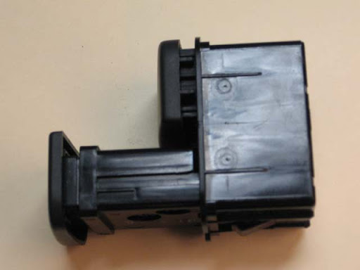

Go ahead and pull the switch out and look it over.

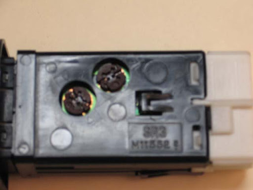

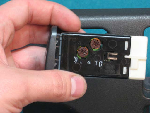

Weíre looking for the bulbs. There are two:
Youíre probably better off replacing both of them while itís out.

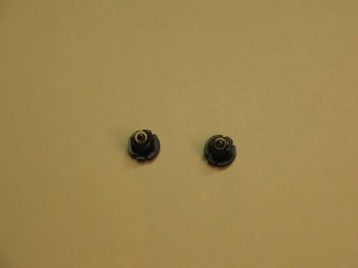

To remove them, give them a bit of a turn counterclockwise until they unlock.
Tweezers come in handy getting them out:
Now for the lights:
If you look at the bulb, youíll see that there are two wires that come out and wrap around the holder. Youíll want to unwrap these wires and pull the bulb out. I recommend you only do one at a time. The reason is that the replacement bulbs sometimes have slightly different dimensions than the original bulb. If you have something to compare the new one to, you can account for this difference in the way you position the new bulb in the holder. If the bulb is not positioned right in the holder in relation to the filament, the light output will be affected, and it can be noticed.
As you can see, the new bulb has quite a bit of extra wire. This will need to be trimmed, but not yet.
Check the way the bulb sits. If it sits just like the old one, then cut the wires off as close to the same length as the old ones as possible. If not, gauge the difference and trim accordingly. I just used the knife to trim the extra off, but scissors work better. Itís easier to remove the bulb again to compare lengths.
Once youíve cut it, then put the bulb in the holder, and wrap the wires back around the holder like they were before you unwrapped them.
Ideally, you wonít see a difference in the bulbs.
Time to put the bulbs back:
Into the holder:
Clip the wires back and install:
For those of you blessed enough to have an Ex or Si, the process is much the same for the cruise control switch. The OEM foglight switch is the same switch as the cruise control switch. Only the face is different. The body of the foglight or cruise control switch is also the same as the rear defroster switch. Only the internal switch and rear cap are different.
If you did everything right, the indicator light should come on when you press the button, and the back light should come on with the park lights and head lights.
Any comments/corrections would be appreciated.
