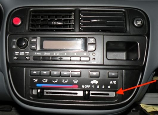

Fan, as in the one that is turned on, off and controlled here...

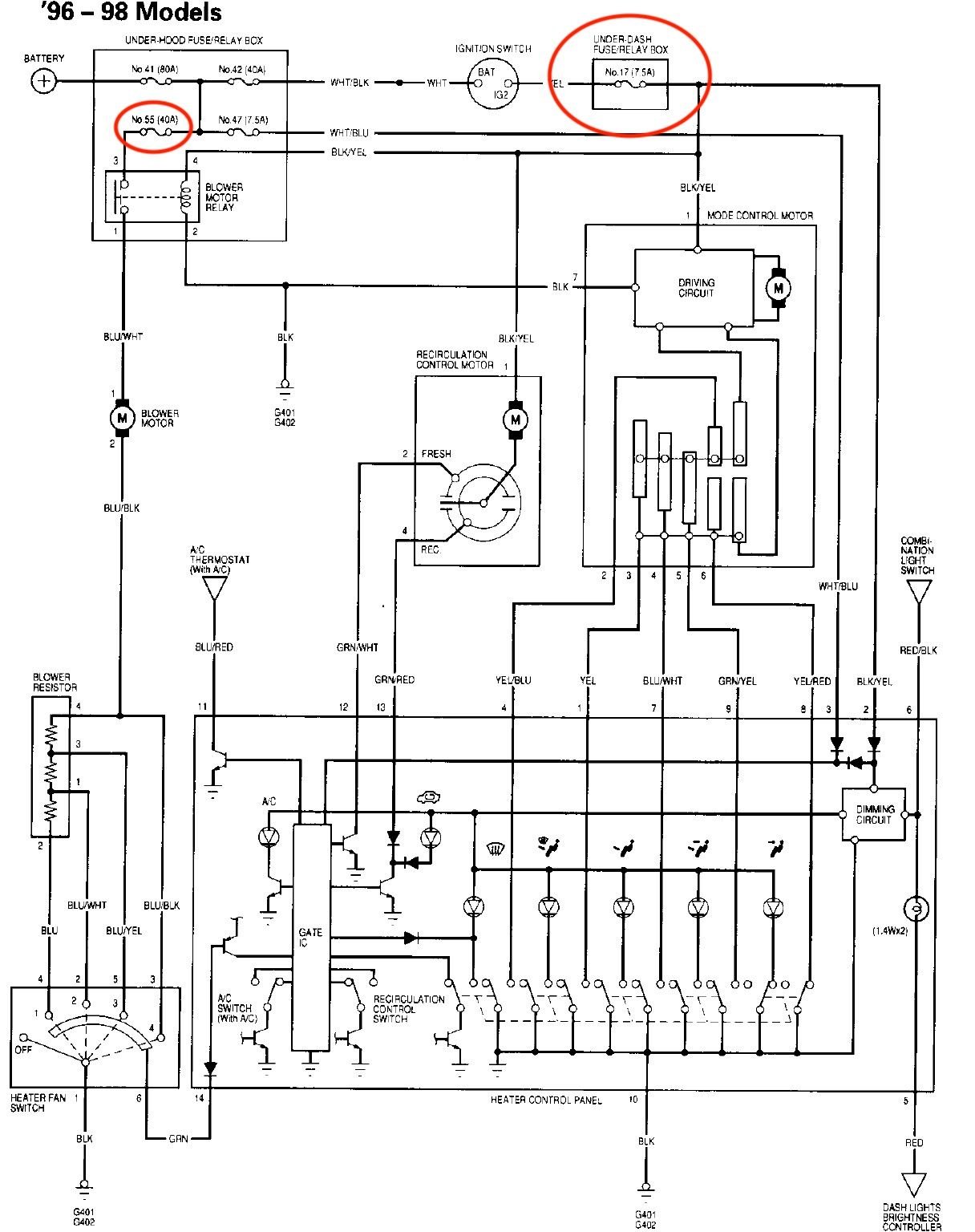

Check these two fuses:

Locate the blower motor under the dash all the way on the right side. The 2 wire plug with the large blue-white and blue-yellow wires should be visible. Turn on the key and set the blower switch to 4. With the plug still plugged into the motor, measure the voltage from each of the wires to ground.
No power on the blue-white wire: blown 40A fuse under the hood, lack of power from the 7.5A fuse 17, or bad relay under the hood.
Power on the blue white wire, also 12 volts on the blue-black wire: Bad blower switch, resistor, or wiring on the ground side of the circuit. If you jump the blue-black wire to ground the motor should take off at full speed.
Power on the blue white wire, zero volts on the blue-black wire: Motor is bad.
Thanks!
Took a look, at both and neither one appears to be blown or burnt.
g4384063 is offline
