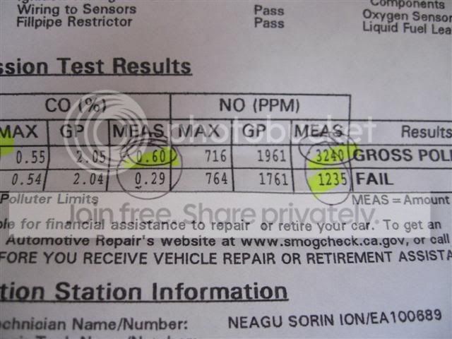

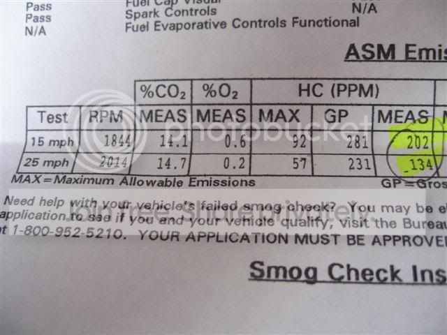

Well I got reff and I failed my emission and I was wondering what could cause this dramatic number difference. Could it be the fuel evaporative controls unplugged?

I changed my oil, spark plugs etc. And i just changed the o2 sensor maybe a few months ago.

I just read something about that it cleans the gunk out of your fuel tank. But using alcohol does some fishy.
Anyone know about the fuel evaporative controls?? Do you guys think that is what throwing those numbers

I dont think I could just put a bottle of chemical and it will dramatically drop my numbers in half. There has to be something that is off.

I would have your 02 sensor checked. You still have o2 in the exhaust which means the cat was either not warmed up enough or it is not getting the proper mixture.
How long have you had the cat on? has it been sitting?

If you put it on and drove it in there...YES. The cat will oxidize and the oxidation will reduce it's efficiency. you should have ran it high in the rpm's for at least 30 minutes to burn of the oxidation.
Now if you put it on and drove it a few days then NO.
You said that you changed out the o2 sensor a few months ago, I had one that only lasted six months. That is why I said check it out.

now yes alcohol does work because the byproduct of alcohol is less than that of gasoline when it is combusted... but rubbing alcohol i wouldnt try it i have heard that denatured alcohol will work but havnt had any personal experiences with it... as far as timing retard it to 2 degrees under standard should lower the nox a lil bit but from those numbers i would say you were running rich at the start or your cat is shot or it was cooled off by the time they started or like everyone else said check the o2 sensor those things are really sensitive and im assuming you didnt opt for a new oem one but one from pepboys autozone or something like that... im not a mechanic but have taken a few classes and prefer to do everything my self so i have learned from mine and friends experiences.. best of luck..
