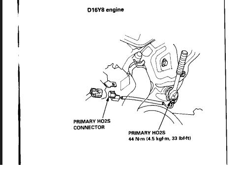

So I have a big question mark on mind according to this diagram striaght out of the Haynes my primary O2 sensor should right in the manifold as displayed
But looking down personally on my car my Primary O2 sensor is set where it should be on a B16A2
Could this be messing with the numbers the Primary O2 sensor puts out due to it not being in the right spot?

Yes for the EX (D16Y8) the primary o2 is located like this : http://www.hondaautomotiveparts.com/...0201_e0401.png just like the first diagram
My guess is it shouldn't effect the secondary o2's reading.

Yea the EX Z6/y8s that had the more ideal stock exhaust manifold setup have the 02s down low. The DX/lx etc manifolds got the upstream 02 right off the block. Changing exhausts between engines is fine and all you need is pigtail extender for the 02 plug so I would imagine the position doesn't matter much if any for reading it's placement is based on exhaust design.
