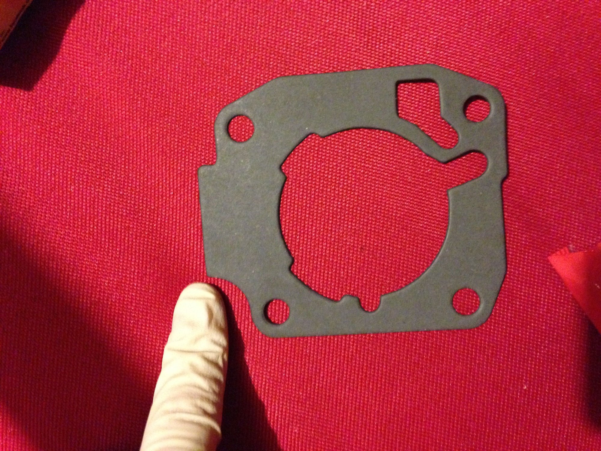

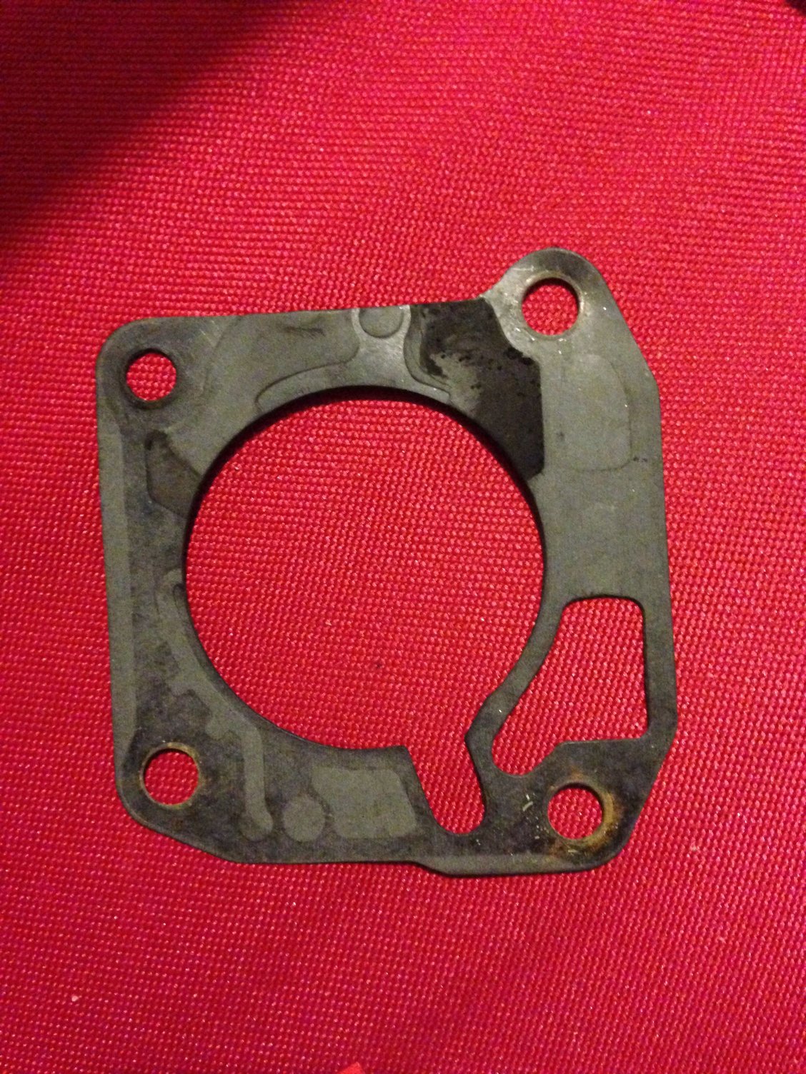

Don't worry as long as you are getting help that's all that matters. I solved my issue. When i replaced my TB gasket autozone sold me the wrong gasket and it was even labeled "D16 96-00 manual trans." Ill post pictures.

This was the original TB gasket autozone sold me. It was missing the a little extra gasket on the edge to cover the IACV air passages in the TB which would cause a vacuum leak and create the fluctuating idle I had.
This was the second TB gasket I bought(the right one). The part I'm pointing to was the part of the gasket that was missing from the original gasket.
