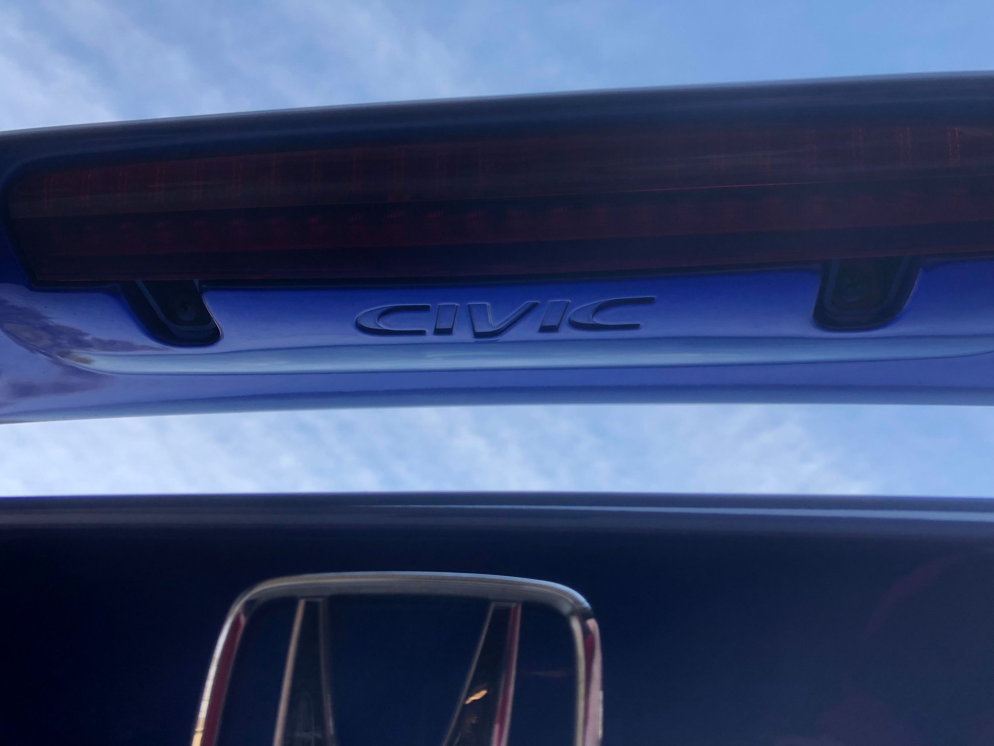

You need to cut the bump stops in half by the way. The trunk spoiler on the blue EM1 looks aftermarket,...is it not? The overhang on the right is an eye sore.

Not cutting the bump stops on the progress because I’m barely going less than stock height and that was progress recommendation for my ride height, and it’s 100% stock spoiler

Does the factory wing have a brake light in it ???
They do...and also has "CIVIC" indented near it, on the underside.

Yup! As far as sticking past the trunk lid on the right side, the spoiler is slightly wider than the trunk so it hangs over on both sides a little bit, nothin you can do about that
