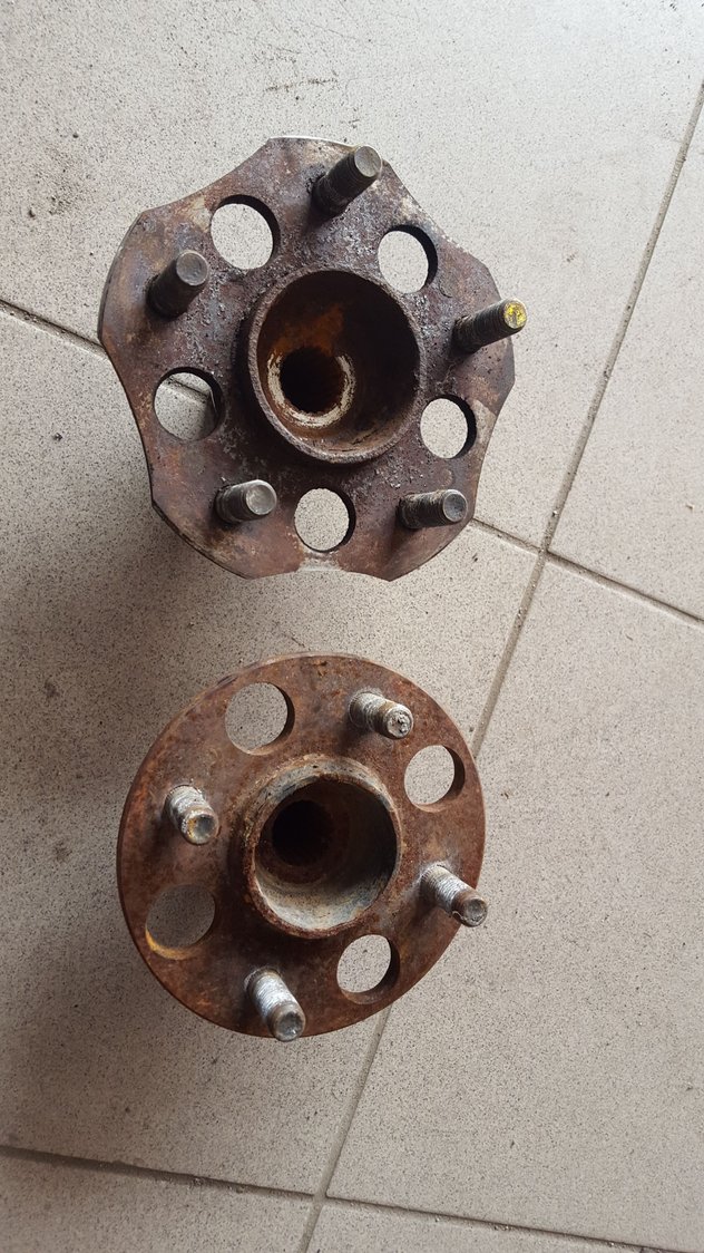

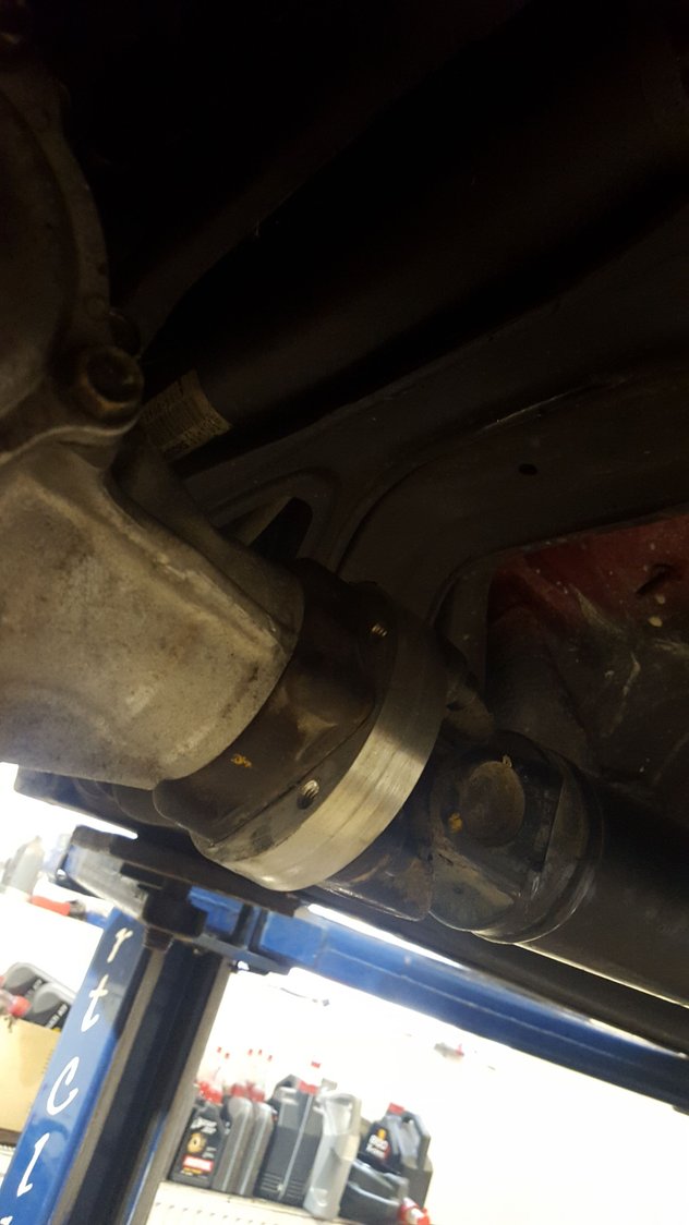

I have built CRV transmission with sperr and the awd parts are from shuttle. We have self made the rear hubs for the rear shuttle bearings. And we have made an intermediate piece between the crv transmisson and the shuttle cardan.

Closer pictures of the rear dif mounted?
