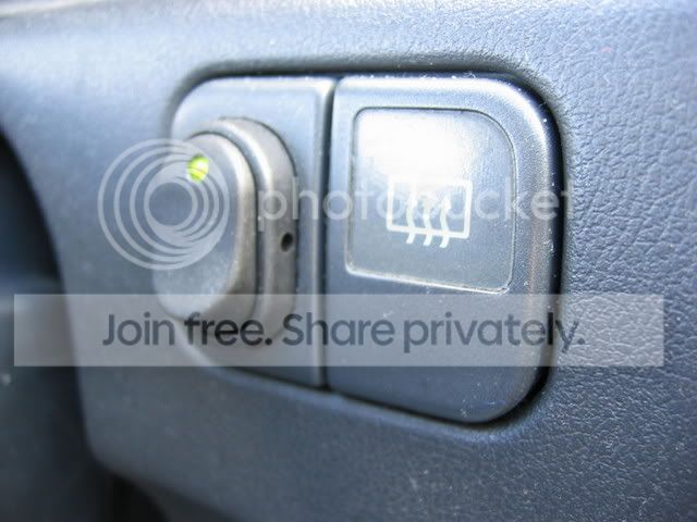

I installed some Raybrig EK fogs (from passwordjdm) in my cousin's 00 sedan, the harness is different from the genuine Honda EG fogs, the Depo fogs, and the Esuse fogs. There were 2 big male/female plugs by the steering column that's bridged together by the EK harness. I don't remember seeing that in the EG.
Another option is to get a EG fog harness. Or you can just use any universal fog/auxiliary light harness. Price ranges anywhere from $10-25, depending on where you buy it. You can either splice the universal harness into the the EK fog wiring (you'd have to cut off the plugs), or use female spade connectors to connect to the plugs on the EK fogs.
I mounted a rocker switch onto the block off plate by the defrost switch. Other places you can mount the switch are on the block off plates by the parking brake.
