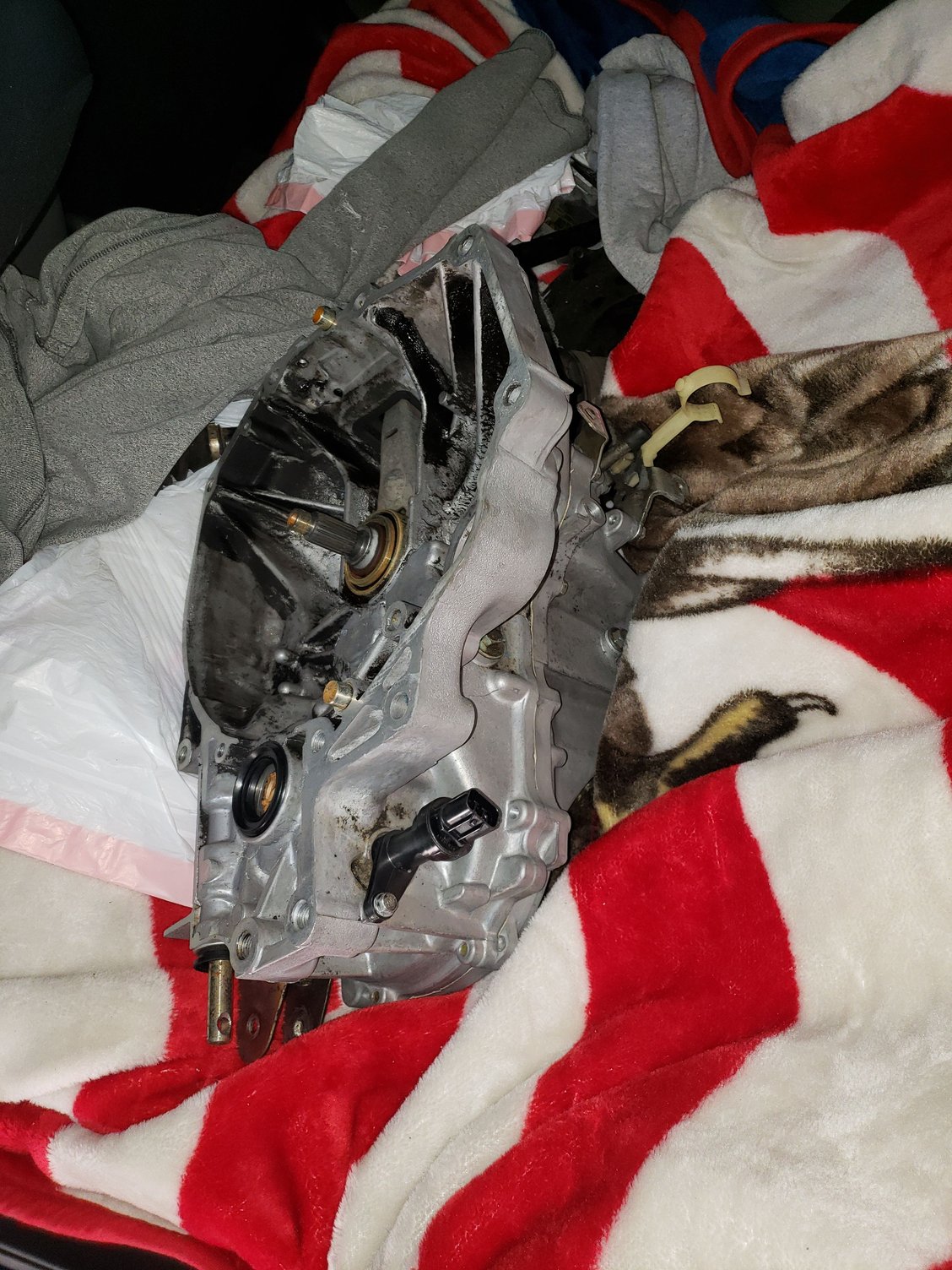

pic of said tranny after I got home with it if that helps any. Looking at it now maybe the insides are rusted out? Idk

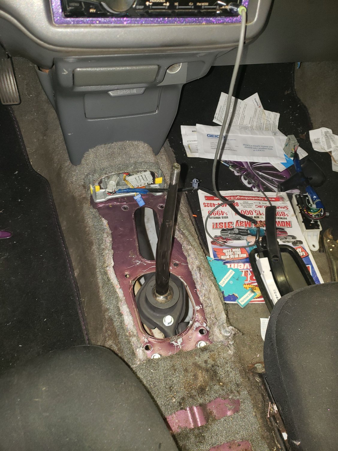

This is obviously the shifter stuck in what looks like third to me. The shifter is turned the correct way yeah? I'm 99% sure it is, but **** maybe I'm retarded? Does it even matter?
ok after looking at the diagram for the shift lever the bend is towards the back so its correct.. I think.

Disconnect the linkage at the transmission then put a screwdriver through the hole in the transmission shift rod that the "bitch pin" goes in. You should be able to move the rod in and out of the transmission in three distinct clicks, these are third, neutral, and fourth. In the neutral position you should be able to rotate the rod side to side, pushing it in or out in the rotated position selects 1-2 or 5-R.
definitely a no go. Tried that this am actually, after I figured out it was possible. Tranny will be po pulled in the am and I gonna find out what's up. Appreciate the reply.

The clutch housing appears to be newer and NOT the original matching factory part that was mated to the transmission housing. BIG RED FLAG !!! This change is a challenging one and your average home hobby mechanic is not prepared for this job. Open up the case, take pics of what you see and post them up here so we can help.
Another thought: Take it back to the seller and get your cash back. Next, buy a transmission from a RELIABLE source instead of the best price on CL.

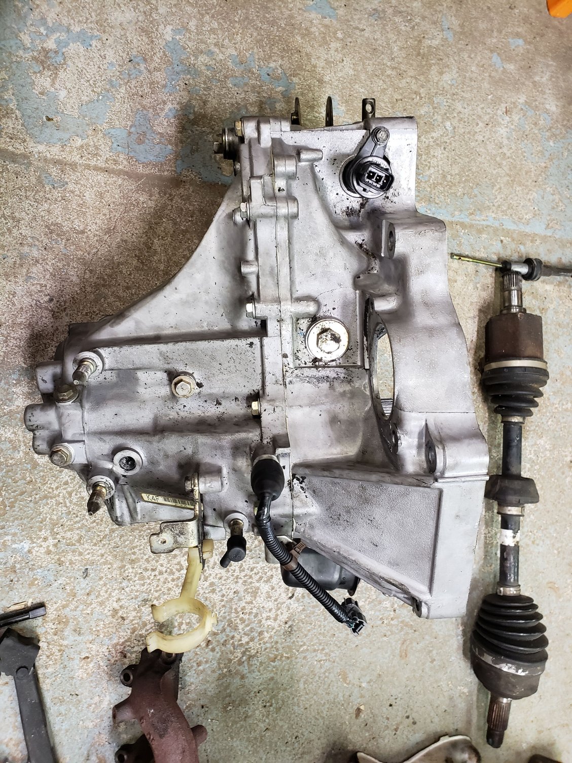

what makes the clutch housing appear newer? The color in the pic? Tranny will be out today and I'll pop it open. First time, but I'll throw pics here and there are like 19 different guides for taking apart a d series tranny.
yeah that's my bad on the clist. Idk he just had a clean looking ex tranny.
You can see the whole tranny a little better here. Does the clutch housing still look newer?
I should have it out today. I'll get better pics.

got it out. Put screwdriver into shifter and gave a jab with my palm and it hit neutral. Not even sure it needed to come out. Got it into third. After going through each gear it started getting easier. Maybe he left it outside and it got a little rustic. Idk. Gonna reinstall prolly next weekend and see what we get.

Yeah, looking at your newer pics my suggestion appears to be out of place. Maybe it was the lighting... but the case colors look very uniform in the above pics. Glad to hear you got it moving... while you have it out, you might still crack it open and see if there are any issues that need to be addressed instead of just putting it back in and hoping for the best.

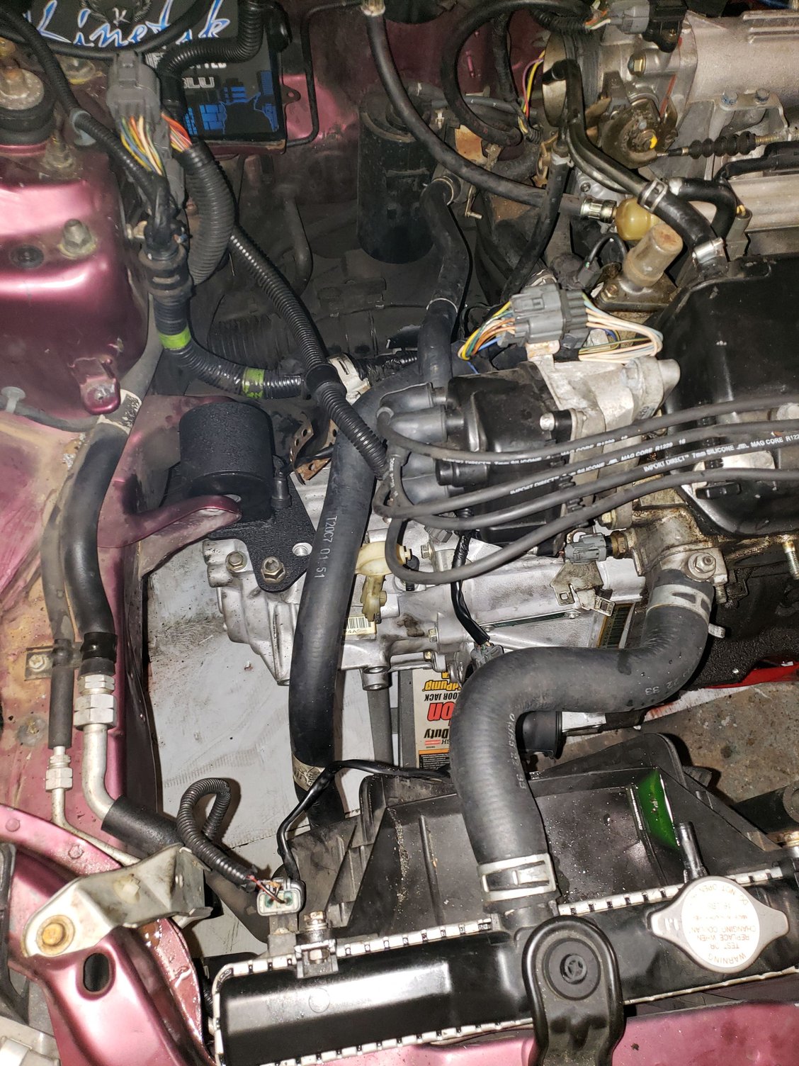

so against you guys, and my own, better judgement I decided to put this tranny back in the car. Well when it's in I dont have 5th and reverse is ehhh, but goes in. So I'm like **** it.
Got the car on the ground for the first time in a while anddddd it wont move! It was like 2 am and I was ******* pissed. Next day I changed the passenger side cv axle and viola lift off! Buttt the tranny is leaking from where the cv axle meets the tranny. So I dont leave the driveway yet.
so I go get a seal and put it in 4 different times and I still have a slight leak. Well I had jury duty and I'm like **** it your just going with the leak. Fortunately I took it on a test drive, the passenger side diff broke in under 5 miles...
sooo I've already got another tranny (that i shifted thoroughly prior to purchase!) That I'm gonna install next weekend. And eventually rebuild the piece of **** that's in the car now. Might do it here might make another thread.
