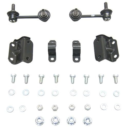

I just purchased Eibach sway bar kit. Does the kit come with everything.
http://www.amazon.com/Eibach-4018-32...d_rhf_dp_p_t_4
I was wondering if i also need the hardware kit also? If i would of know that i needed this i wouldnt of got the eibach sway bar kit. It is for a 1997 Civic LX 4door. Do i need rear LCA also? and wil aftermarket (megan) LCA work or have the hole in it for the end link?
http://www.amazon.com/gp/product/B00...SIN=B002C3Q6Y2

I have seen that article, but i am unsure if the kit comes with the mounting bracket. And yes i did buy it blind. Car is at a local shop. So does the kit come with it or will I have to be making another purchase for the mounting kit?

the post above answers almost all of your ?? and if you scroll down on the link you posted there is a review thats says it did not come with mounting hardware. i think tire rack has the same kit cheaper .
