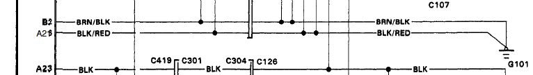

There are 4 ECU pins you can test.
Unplug ECU connectors A and B.
With key OFF, test for continuity to body ground at ECU connector pins A26 and B2.
With the key in ON(II), measure voltage to body ground at ECU connector pins A25 and B1.
Post the results.

b1 and a25 right or am I doing b2 a26
Old 05-08-2016, 08:47 AM
  #46
Former User's Avatar
Join Date: Feb 2008
Posts: 45,219
Received 44 Likes on 22 Posts
Default Re: EG Civic/built ls turbo - fuel pump won't prime and CEL doesn't work
B1 and A25 are DC voltage to body ground measurements, which should be no more than a volt below battery voltage.
B2 and A26 are Ohm measurements, testing resistance between each pin and body ground (metal frame under dash).

when I have the tester in the position you have the arrow at I put the red prong in the clip touching pin b2 and the other prong touching ground under dash even used my ebrake metal and the tester read 1 or a .1 and same when I read a26 but when I touch both prongs together I get 004
Old 05-08-2016, 09:18 AM
  #50
Join Date: Feb 2008
Posts: 45,219
That's a problem
