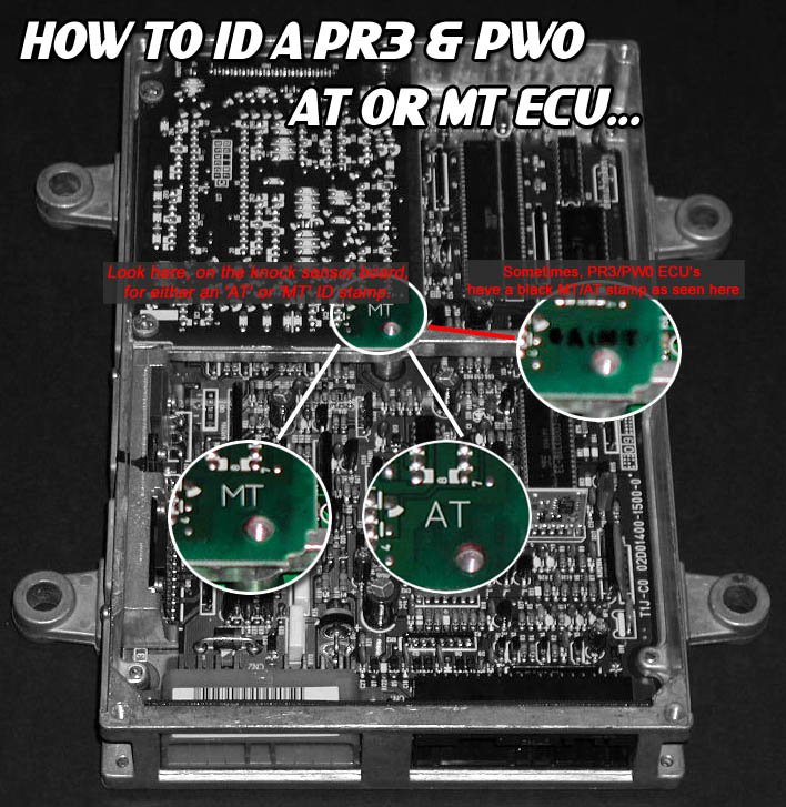

How can you tell thew diffrence between auto ecu's and manual ecu's??
We'll go with p06
And yes ive searched with no luck. i was given a p06 so i was wanting to know what it was

plug it in it will run a lil funny and through a check engine light cause the computer wont be shifting and i wont kno why!

you will get a CEL like said...you can also tell by opening it up....if for some reason you have an auto and need manual...use this link...you can also see pics of how a auto and manual ecu looks like once you open it..

"All of the OBD1 ECUs I have seen which is about six have the letter "A" as the first of the three characters after the model identifier. For example 37820-P30-A01. The automatic ECUs don't have an "A". I don't know if this is consistent. It is only my observation."
