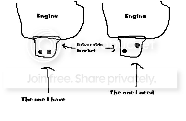

I am putting an LS into my 97 HX. I have avid motor mounts. And the driver side mount doesn't line up with the bracket. So I need to know which bracket to get. I

it has to be from an em1 (99-00 si)

ehhh... i used my stock mount for my b16 on the driverside. it worked. wiggle it around.

YEP it's gotta be off an 2000 si, ooorrr if you really want to get ghetto depending upon which mount you have you can reem the whole out the one i had was REALLY close and barely needed to be modified so if it's that close that'll work
well nevermind after lookin at the pic you would straight have to tap that one

Well there's no wiggling this one to make it fit. Its way off. So I guess I'll get the Si one. Where's a cheap place to get one?

its like 80 at the dealer, and that doesnt even include the studs which are another 6 each. Here is one I found on ebay, bid that **** up!
