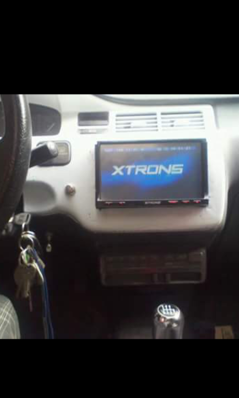

i did a double din in my 93 i wanyed it to stay up top so i took out the climate control and cut out the ash tray and cig lihter spot and now the climate controls all mounted their and looks great as well as my double din in the top but you will have to do alot of fiberglass work to make it look and fit right. have un and good luck

This is after i got everything fitted amd ready for sanding
This is in the location of the ash tray and the cig lighter u still get the po ket below as well with the way i did it cost about $7 in bondo and $15 in fiberglass
