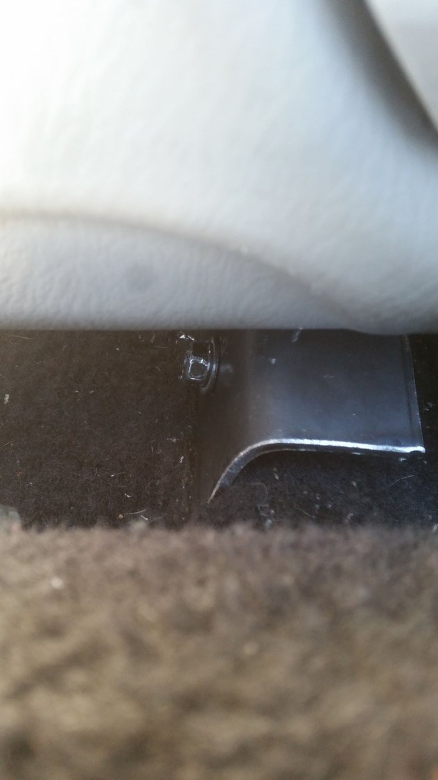

It took a couple days to figure out how i wanted to bolt up the fronts, but i ended up drilling the rivets out of the rails holding the mounts on all but the flat mount on the rear inside of the seat. I cut and shaped new brackets, and then with them sitting on the hump and the seat in place i marked and drilled the holes. I tried to make the seats sit a little lower and a little more towards the rear of the car. I want to weld the brackets onto the rails eventually, but they are very solid as of now.

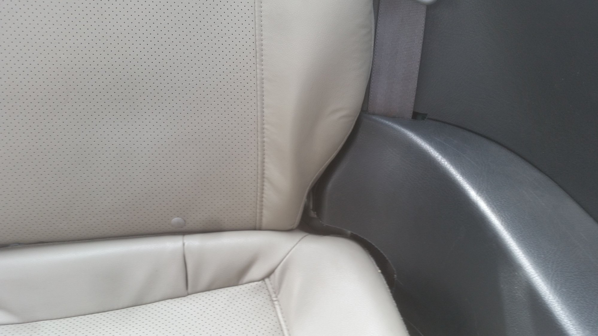

The rears are where i had to figure it out for myself, since everything i read online said rsx rears in the coupe doesnt work.
First i started out at the bottom. The rsx seat are much wider at the back but skinner at the front. I pushed the seat back as far as i could and marked what i need to cut out. I would rather cut up plastic trim then seats so i went this route.
Drivers side
Passenger side
I didnt want the seat belt riding on the leather so i cut slits out for it to track through, and the belt stopped the seat from sitting back all the way. I also had to bend some of the frame in the cushion on both back corners to get rid of some of the over hang
I havent decided on what way to mount the front yet as the metal tabs that lock it in are more towards the center and straight on the rsx seats. For now i have them folded almost flush with the seat. I removed a little bit of foam from the front corners of the seat as well. The back mount was just bend untell it lined up with the existing hole.
This part made me a little nervous. The rsx rear seat top section was a good 4-5 inches wider and 2-3 shorter. This is when i almost believe the internet about this being impossible. But i said to hell with that i want some leather seat all around. I removed the seat pan from the rsx seats and my old back seat. The rsx being a two piece section and my old one a single piece. The mounts were way different, my old seats locked in to place right were the rsx seats split. I laid them on top of each other and traced were i had to cut. Manly the locking mount on the rsx seat had to go and they should fit. I hacked them off and about an inch off the back plate, i then folded the cut egde to prevent it ripping and cutting the seat. I put the pan back onto the seat and bolted they up one at a time. I had to squeezed the foam a little on both size to get them all the way back but they fit like a charm. You have to use the rsx hinge but they bolt right up.
