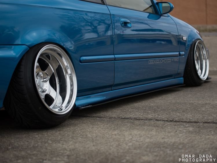

Hey everyone,
Just curious if anyone on here is rocking the side skirt splitters from DevSport?
Info and pics right here
I noticed there was no install guide included, but figured it was fairly straight forward...
But after poking my head under the car, it looks as if the bottom of the factory skirt sits against the bottom of the car. Not leaving a lot of room (if any?) for the supplied bolts/nuts to attach the splitter to the factory skirt, without interfering with the bottom/shell of the car.
I did a bunch of searching, but couldn't really find any info, so I'd figure I'd see if anyone on here attempted, or managed to install the splitters themselves? I'd love to tackle this job on my own, but I also don't want to make a mess of it, only to have to take it to a shop for them to fix it lol.

Mainly because the side skirt is doing what this is trying to do. Now if you were to take this, attach it to an actual flat panel underbelly, or rather make an underbelly panel that actually goes all the way out passed the side skirt, it would be effective.
The PCI side skirts are so long for a reason. That reason being, is that it blocks air from going under the car. This is effective with an actual front airdam/splitter which stops the air from entering under the front of the car. Couple that with a rear diffuser/panel, and you don't actually need an underbelly in the middle of the car, because you are keeping the air flow outside of the area.
These pieces of plastic are not doing much of anything alone. But like you said, you're building your car for the 'look', and not actual function.
