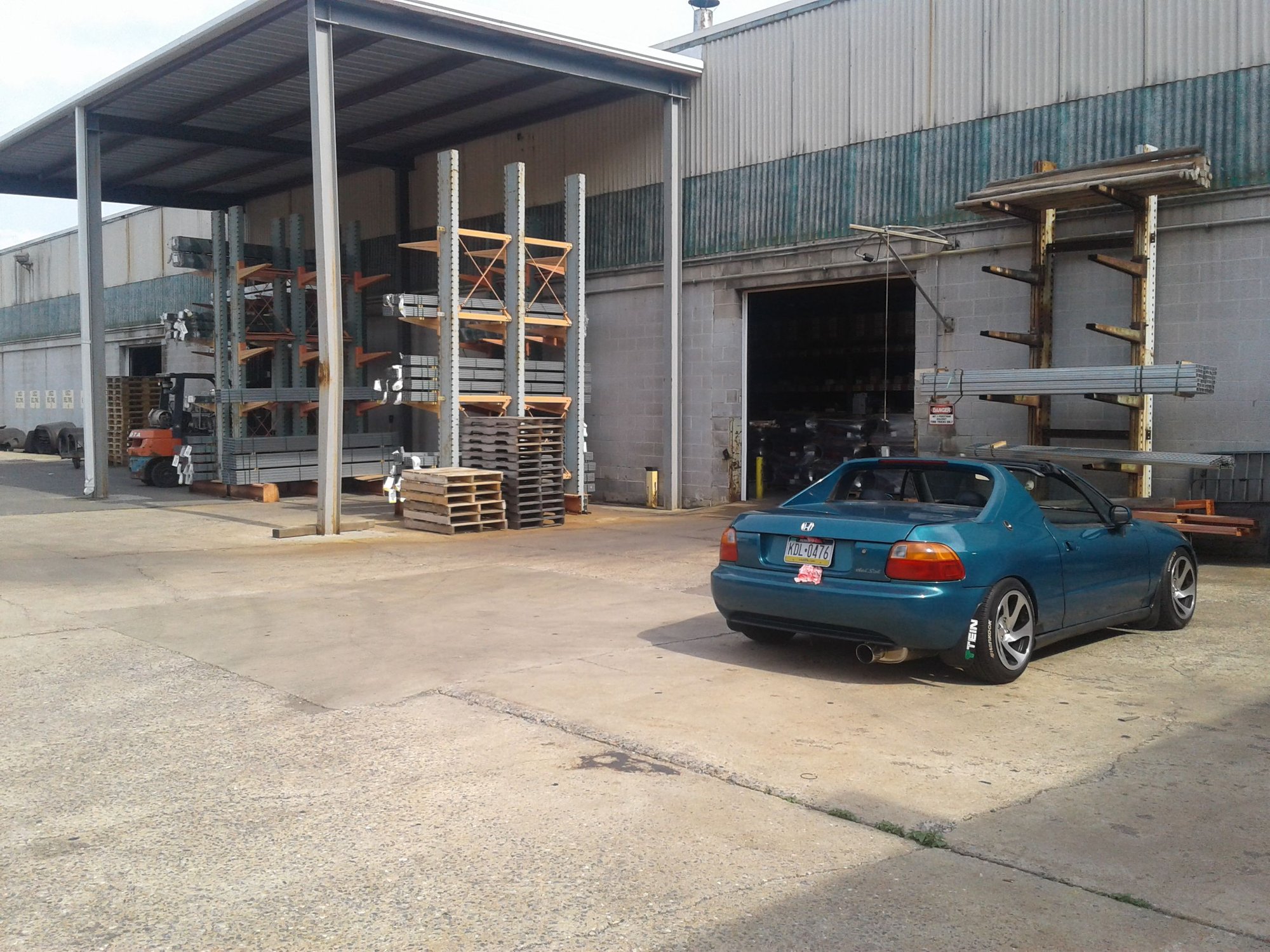

Also, here's my car.

A year ago I acquired a 1995 Honda Del Sol Si with 243k miles on the clock in 7/10 cosmetic condition. Over the past year I've familiarized myself with the car by installing coilovers, changing fluids, cleaning the throttle body, timing belt, several cosmetic upgrades etc. It is an amazing car to drive and takes corners better than I can drive it, but I feel that it needs more straight line power. I was struggling to decide whether I wanted to swap or turbo all the year long, and the cons of the swap outweighed the pros for me personally. I've decided to turbo my Del Slo with a power goal of 220HP. Many of the write-ups online have far greater power goals, and I'd like to avoid overbuilding (budget conscious). My budget goal is $2500, which from my research is about the lowest you should go if you're gonna be daily driving your turbo'd Civic. Here are my intended means of getting to that point:
Modz:
- Custom leather seat covers for original seats - $200(no fading or cracks, very happy with them)
- Tanabe Medallion Catback - $500 (muffler rusted off, figured I'd replace it with a high dollar exhaust)
- Tein Control Master Coilovers - $400(great craigslist deal on high $ coilovers)
- eBay wheels - $300
- Hankook Ventus V2 Concept 2 all seasons - $60 per wheel
- Mudflaps - $60
- 2 10" subs and kicker+polk speakers up front - came with car
- eBay LEDs and eGay housings - $250
