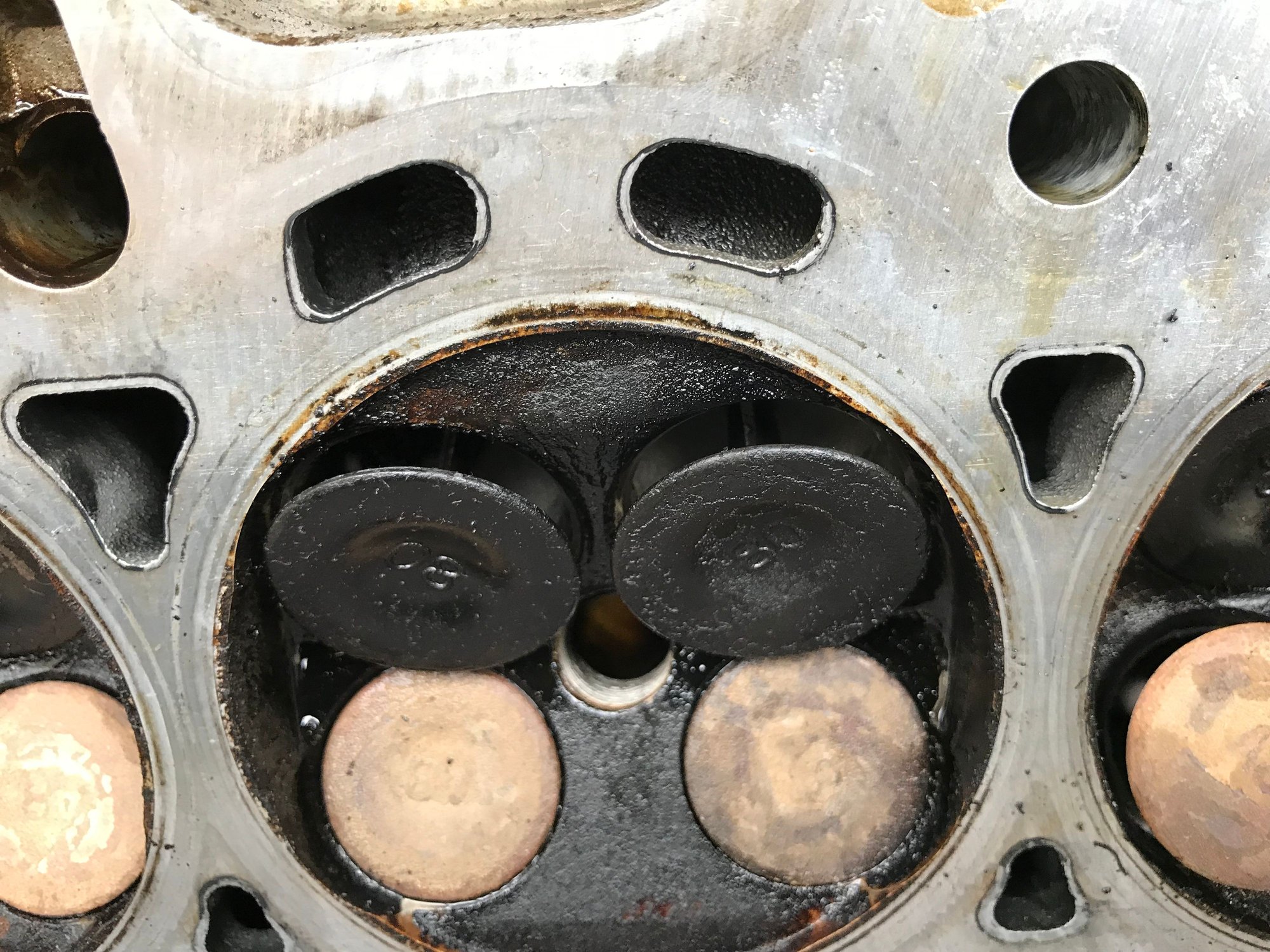

Does these valves look ok or do I need a new head?

I don't see anything visually wrong with them, you will have to test for valve guide play. Then just relap them and it will be fine assuming the valve guide play is within spec.

Did you compression test the cylinders? If so, what are the numbers?
