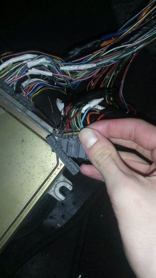

I just found a wire leading to my ecu that was partially coming out. It's the yellow and black wire, I tried to rip it out the rest of the way, do u think this is my problem
The ECU connector is trashed and could be contributing to the problem. However, given that the 1-7 test did not make the pump run, you need to voltage test fuse 31. Click the Test Fuses link in my signature.

Fuse 31 gets 12 volts at each pin, I bought a new ecu and the guy I bought from plugged in to his honda before I bought so I know it's good, both ecu I have are virgin p28s I'm gunna try to go to junkyard tomoro and get a new harness

If 1-7 does not make the fuel pump prime, the ECU is not the problem. The Yel/Wht wire running from fuse 31 to the main relay connector is broken.

replaced ecu harness with a newer one, checked continuity between all ground and all check out, recheck every fuse and wires behind them, still didnt help. pulled up fuse box and checked all wires under. When i opened my ecu and pinned the pins with my multimeter to check for ground only 2 of the pins on plug A had ground and only 2 on showed voltage, any guess? also found out my car has no o2 sensor which is odd
