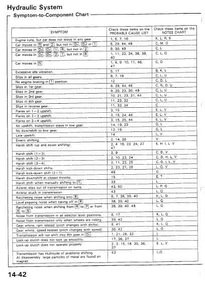

Old 10-02-2014, 05:39 PM
belairbrian's Avatar
Join Date: Jan 2013
Posts: 409
Default Re: D16z6 engine rebuild complete and running but...
these should help
