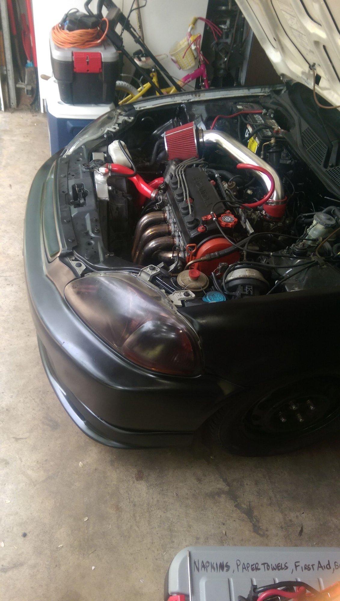

I've been working on my civic for two years and it is running and what not. It will start and idle fine, I can give it gas in park and neutral all I want just fine. When I put it in gear it'll do what it should and start moving forward but if I give it gas it will die on me! I don't think it's a fuel problem because I can rev the crap out of it in park. Could it be a part of the ignition? Any sensors? Anything! Please help! Thank you

The car wouldn't start when we got it, when it would it wouldn't stay idling. We are using a block with lower miles and the same head and intake. Really the only things that are new are spark plugs, fuel pump, radiator, radiator hoses, intake manifold gasket, head gasket is new. I will be putting gas in it, getting new distributor cap and rotor, and wires when I get paid. Anything else I should get? There might be a couple new things that I can't remember at the moment.
