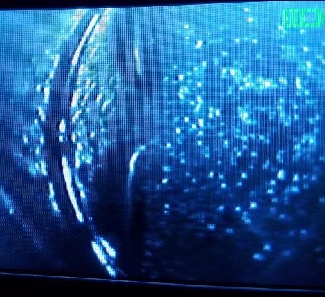

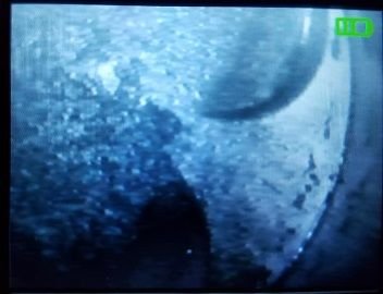

I used my bore scope to see whats going on inside.
Cyl. 1, 2, 4 where wet with unburden fuel and caked with carbon while Cyl. 3 was dry with a tiny amount of carbon. Polishing seems pointless now.

Leak down test will help you isolate why no compression in cyl #1.
#3 is likely dry as it was probably the one that fired (backfired) so burned the fuel the others did not get to.
