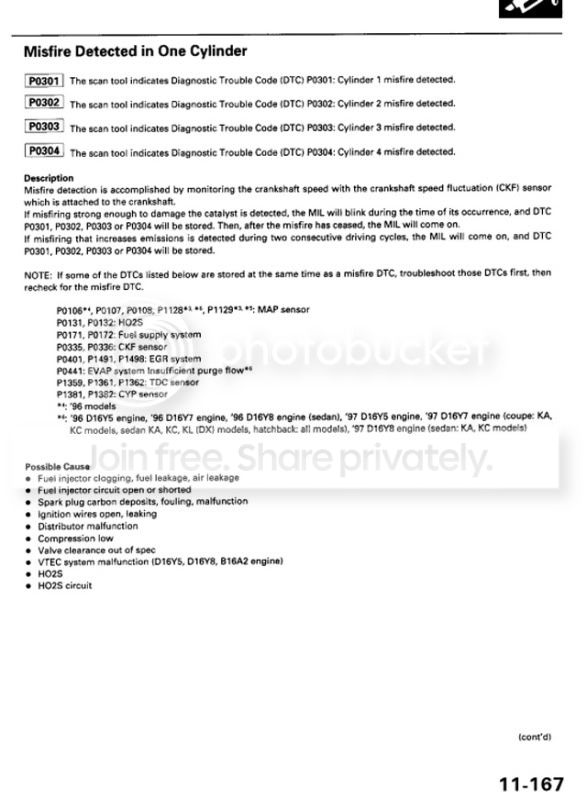

heres what the manual shows for your symptom.....

ok so the plugs are tight they are tourqed to specs, also it is throwing a code p-0304 engine mis fire cylinder 4. so they did pull the injector and clean it but that did nothing. when i removed the plugs they seemed to be in condtion but to me they seemed a little to light grey. the car is a d16y7 so it does not come with an EGR valve that is for the d16y5

so look at the diagram that dc2productions posted... it has your code and your potential problems listed....!?!?

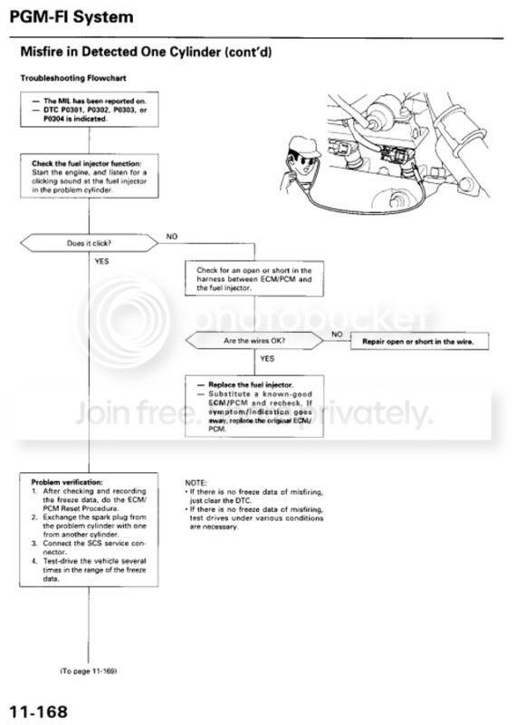

here is the troubleshoot.....
Hope this helps....

wouldnt swapping your wires on just the distributor side mess with you timing? And if you read the troubleshoot, it gives the same method to find problem except for changing the wire itself...
