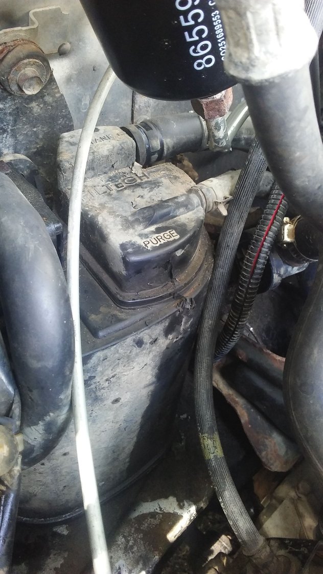

I'm having this problem right now my hoses are mixed up and backwards causinng coolant to be dumped into my charcoal canister my engine is a y7 with a y8 intake i provided photos for wear the hoses are currently at

The canister has two hoses on top. The larger one goes to the hard metal line on the firewall that goes back to the vapor space of the gas tank. The smaller one goes to the purge solenoid mounted on the fuel rail. The canister may have a big hose on the bottom; that one should just be open to the air.
I can't see in your pictures where the hose out of the IACV on the back of the manifold goes. It should go to the large metal coolant pipe that runs across the back of the engine.
In other words the small coolant hose connections are: Intake manifold next to the U shaped bypass hose -> two nipples on the bottom of throttle body -> two nipples on the IACV -> thermostat to water pump pipe

the iacv is in the right spot I checked that it's another hose that bringing coolant in the canister I believe I jsut cant see which one or figure it out

YOUR A GENIUS THIS DOES MAKE SENSE SERIOUSLY I THOUGHT ABOUT IT!!! I went to go fill up my car with gas it wont even let me put gas in there without it clicking every gallon does this information help let me know asap plz

Your last round of pictures didn't show anything useful. On the pipe across the back of the engine, which is full of coolant, there should be a nipple which connects to a hose going to the IACV. Not the canister.
There are three metal lines that run under the car from the gas tank to the engine bay right at the firewall. One goes to the fuel filter, one to the fuel pressure regulator, and one to the canister.

heres the canister
another angle of the canister tell me if any hose is in thee wrong spot
this is the hose leaving the canister going past the firewall
this is a photo above the intake
this by the firewall
throttle body nipple to the other hoses with coolant
hose from IACV to throttle bbody nipple
under the intake bad photo I know
