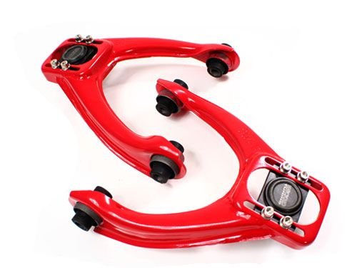

92-95 Civic
96-00 Civic

Thanks. We're actually talking about lca's. And Allen bolts for camber? Sketchy....
