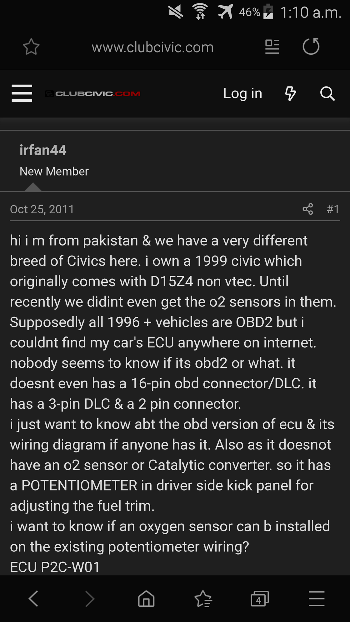

Here is a person explaining the civics in Pakistan on civicclub. We also don't have 16 pin obd connector in my 2000 civic. Secondly have you heard of my ecu P2M? I think no becuase it only came here

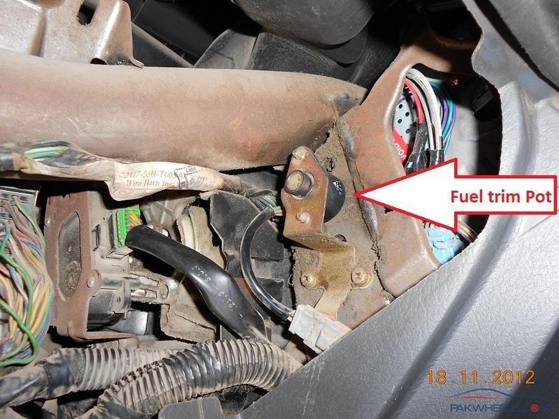

Here is how the fuel trim potentiometer looks like in my civic. Using a screw driver you can adjust the air fuel mixture
