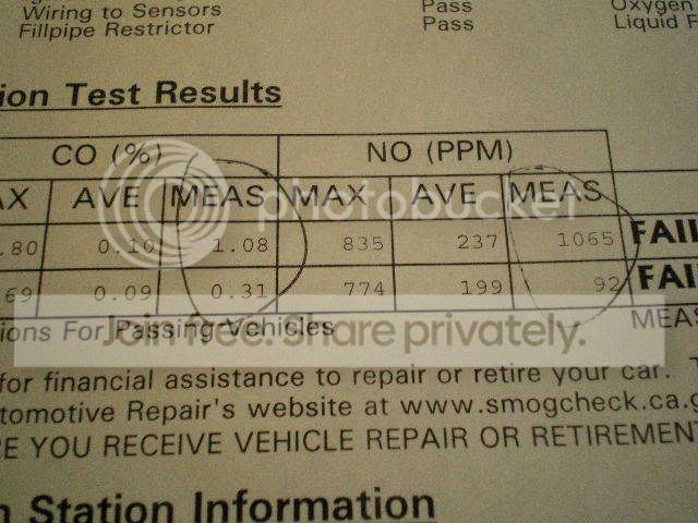

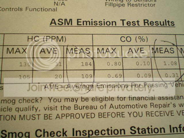

i replaced the o2 sensor and disconnected the negative from battery to reset the cel and i still get the same cel. did i replace the o2 sensor with another bad o2 sensor?

second o2 sensor? i replaced the one on my dc header. had the negative off for 30 seconds or more
can that be the reason i failed my test?
