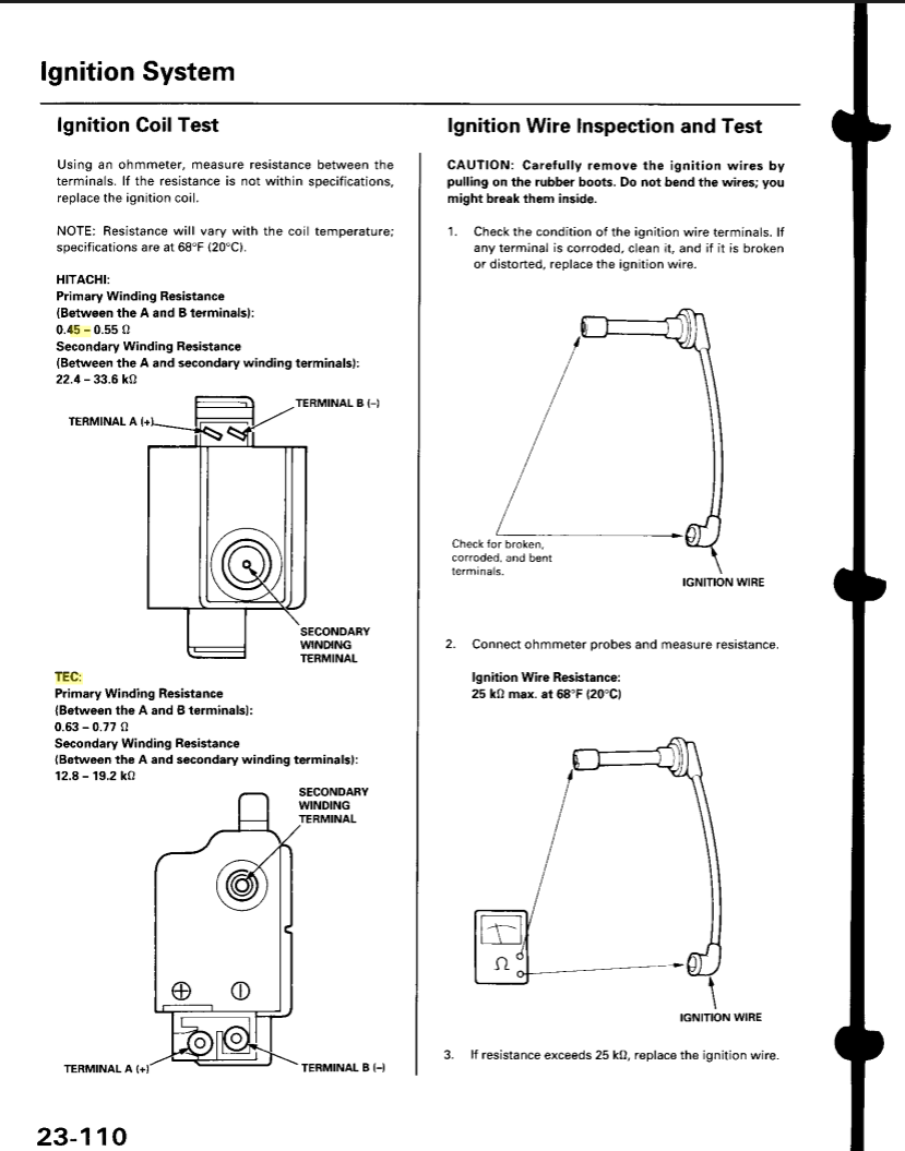

This how you test your ICM.
This is how you test your coil. Be sure to subtract the internal resistance of you multimeter to get the correct reading for Primary Winding Resistance.

Sorry it's taken so long to reply. I had to wait until I had enough money saved up to get more parts. I've replaced the ICM because I had it tested and it failed; however, the car still does not start. I replaced the ignition coil before replacing the ICM so the car did not start. Is it worth getting a new ignition coil and trying it?

I went out and bought the ignition coil this morning and the car started! So it was a combination of the ignition module and the ignition coil. The only slight problem with it now is the slow connection when the car starts. It takes a minute for the fuel pump to click on or something like that. Thank you everyone for your help!
