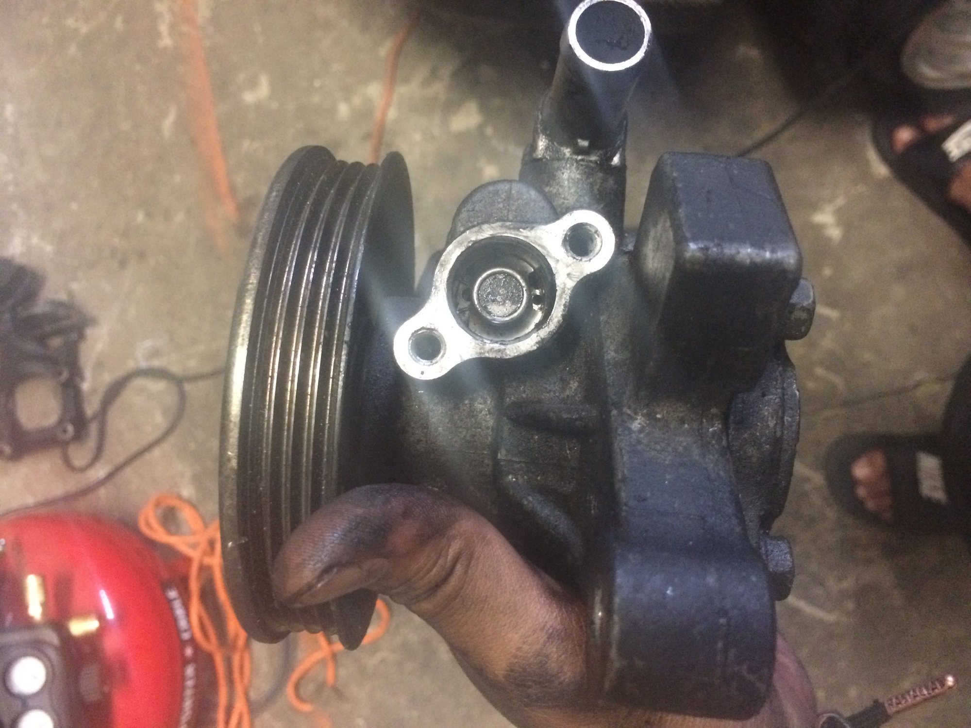

I have 1993 civic hatch I was woundering if a 99-00 power steering pressure hose would work since it pretty much goes with the b-series ps pump that I will be putting in. I’m about to buy the pressure hose online but don’t know if has the same length as the stock eg ps pressure hose

The high pressure hoses are not interchangeable. The better path is to get the "B" series P/S pump that fits the existing EG P/S hose. I forget the model years that match the offset fitting (as you have pictured above), but I think that the '94-97 is one style and the '98-01 is the other. The pump inlet you have pictured above is the inline style.

Do you know a place that sells this b-serries pump ? I’ve been searching for one after reading your post and I can’t find a b-series pump that matches the EG hose?

the only pump that matches the EG hose is the stock d-series pump that it came with... which I can’t use due to it having a weird gap which make it unable to use with the b-series power steering bracket

'94 - '97 Integra uses the correct pump for your existing hose.
