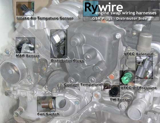

The coolant temp sensor with two prongs on the head has nothing to do with the fans only the fan switch on the thermostat housing.

The coolant temp sensor (one pin) only sends coolant temp information to your cluster. The TW sensor sends coolant temp information to the ECU, and the fan switch tells then fan when to turn on and off.
Exactly what is the code?
