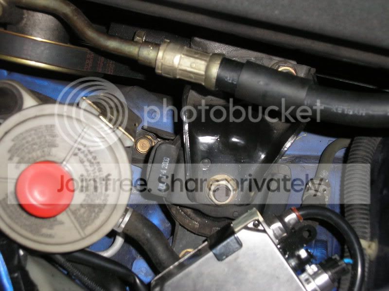

I am installing inserts on my 99 Si, and need to drop the motor a bit to get the torque mount out.
I have to loosen up the driver side top mount to lower it but my PS line is in the way. I have no way to access it.
I can get the one on the right (in this pic) using an extension, but the not the one on the left.
http://i102.photobucket.com/albums/m112/kaluwa3/MM004.jpg
What should I do?

Razr2, whoa, there are other options before removing youe PS and making a mess of things.
how about a swivel adapter, have you tried that? you can get to it with a swivel adapter and a extension.
then there is alittle elbow grease, you can bend the hard line just alittle to clear what you need.
Old 03-26-2008, 09:53 AM
Razr2's Avatar
Join Date: Oct 2007
Location: Miami, FL
Posts: 310
Default Re: This bolt is being a pain in the a$$ (philosofy1)
<TABLE WIDTH="90%" CELLSPACING=0 CELLPADDING=0 ALIGN=CENTER><TR><TD>Quote, originally posted by philosofy1 &raquo;</TD></TR><TR><TD CLASS="quote">Razr2, whoa, there are other options before removing youe PS and making a mess of things.
then there is alittle elbow grease, you can bend the hard line just alittle to clear what you need.</TD></TR></TABLE>
Thats what I was thinking. I'd rather do that and not make a mess.
Where can I get a swivel adapter, and do you think it would fit under it? Not much clearance there? I'm gonna go try using an open end wrench and see if I can get it in there.
I'll let you know. Thanks

unless you have a opened end wrench that acts like a socket wrench and is jointed, i would avoid using it since it's pointless too. as for the swivel, you can pick them up at any parts store for a couple of bucks. they according to your wrench.
yeah you can bend the line alittle to get it where you need (whether it's up, down, left, or right). the eg lines are alittle different, so i don't have to go through your problem.
to do it like everyone else is saying, you would have to release the tension on the belt, slide it out, unbolt the pump from the motor yet still keep the line attached.
to much work if you ask me.

I just used an extension and bent the hose a little bit.

<TABLE WIDTH="90%" CELLSPACING=0 CELLPADDING=0 ALIGN=CENTER><TR><TD>Quote, originally posted by SiYouLater &raquo;</TD></TR><TR><TD CLASS="quote">I just used an extension and bent the hose a little bit.</TD></TR></TABLE>
agreed! i double checked my pressure line and it's quite bendable. atleast bendable enough to fit what's needed to get the job done.
