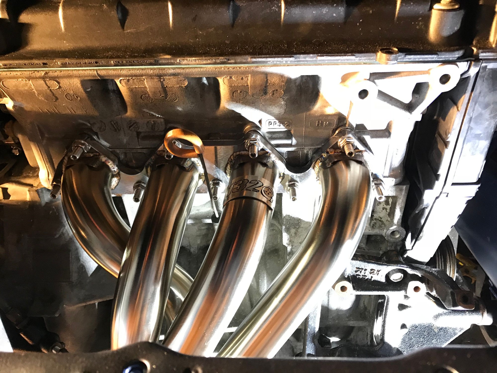

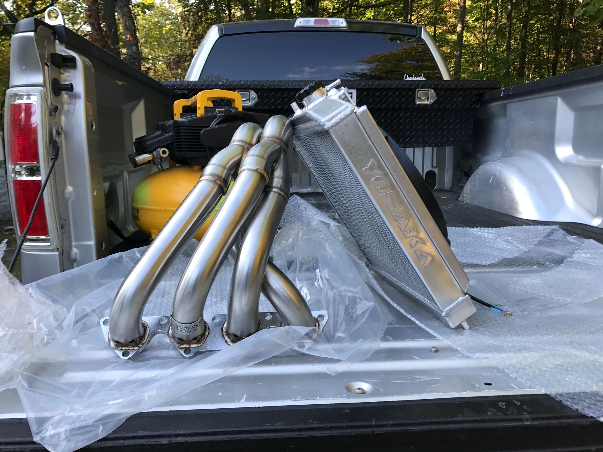

I posted eight weeks ago on getting advice on where to go wit this car/motor, I didn't get much advice or advice that I found useful so I decided to do my own thing. Its been a exhausting eight weeks, working during the day and working on this car at night. well here it is, almost done still working on the rear quarter panel trying to get it straight right now. I don't want to know how many hours I've got in this thing, or how many Benjamin's. pictures are not in order.

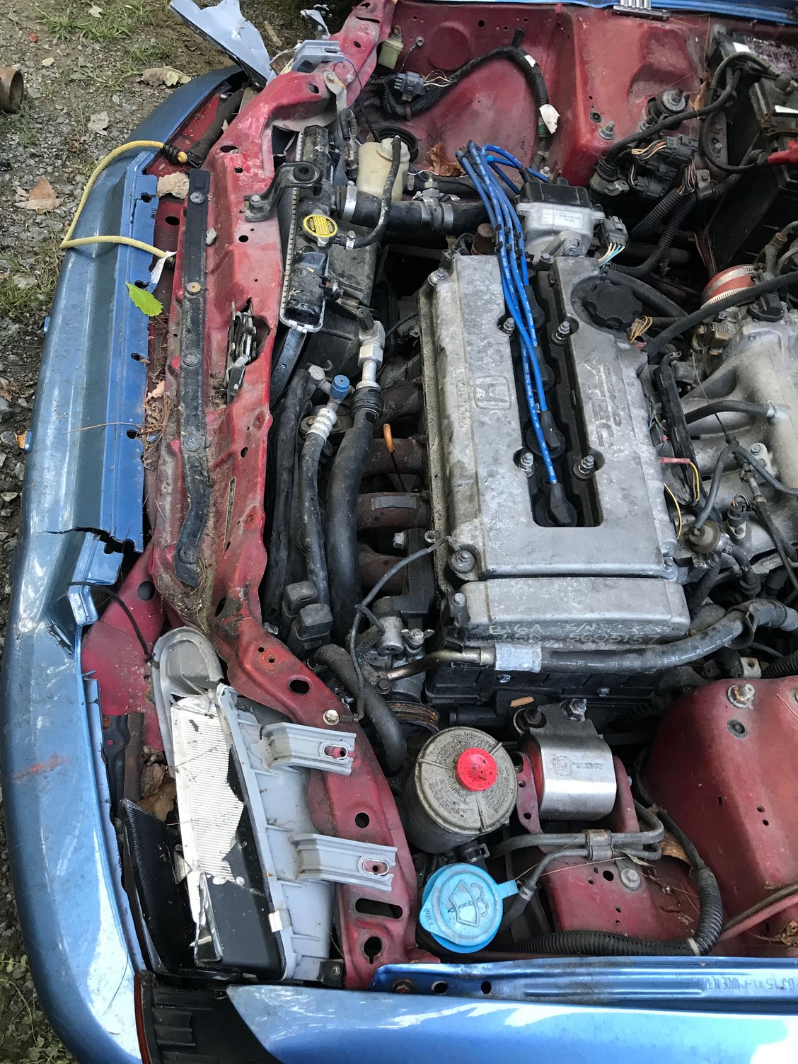

this is what I started with

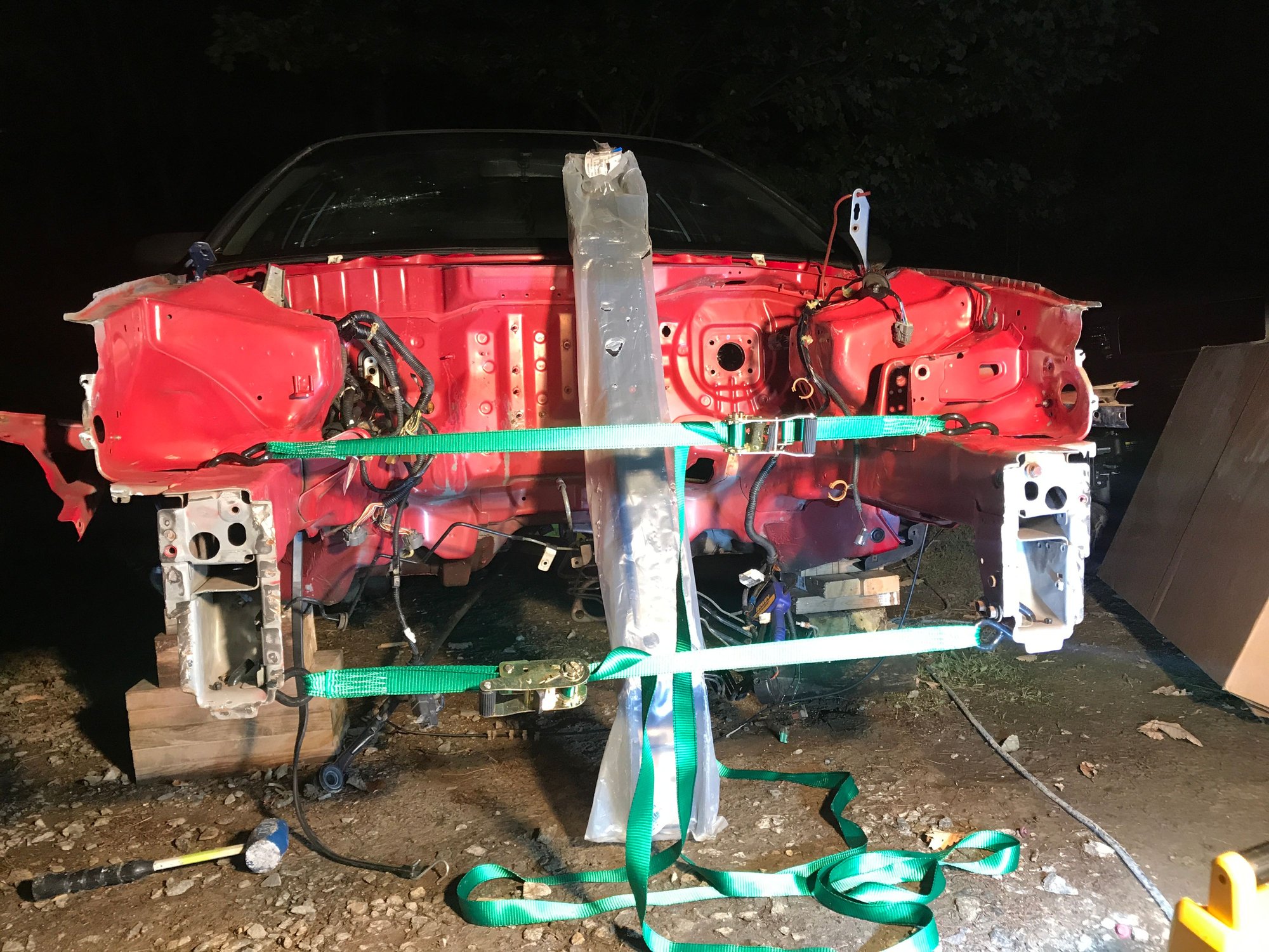

The car was totaled and the owner at the time rear ended a BMW, the front radiator support and front bumper was toast. I bought those off of eBay, if I had to do over again I would have tried to find an oem one. I spent about 6 weeks crawling around in the mud and in the dark before I was able to move the thing into a garage, its nice having light and not having to cover everything from the elements when I got done each night.

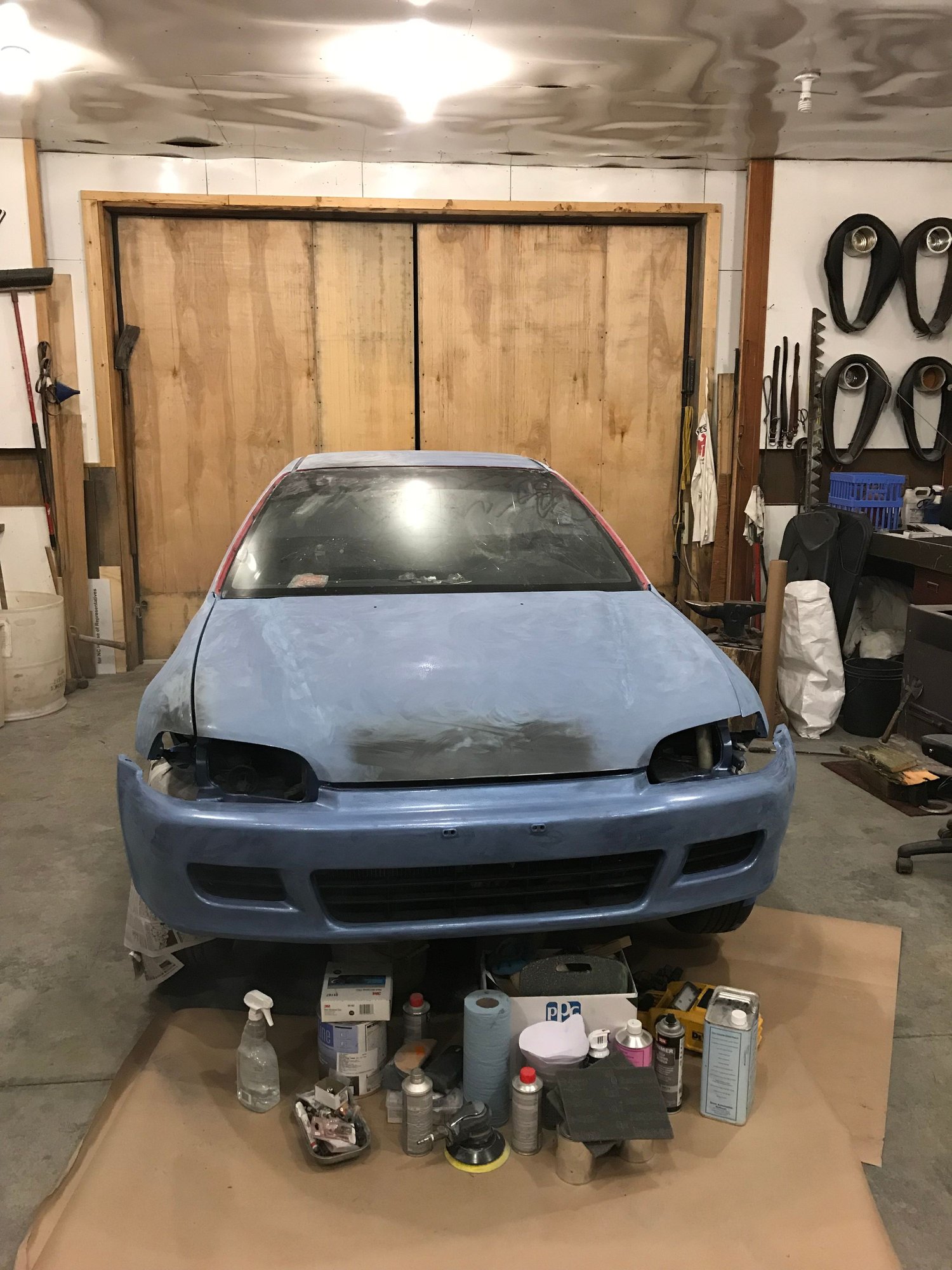

Right before primer
