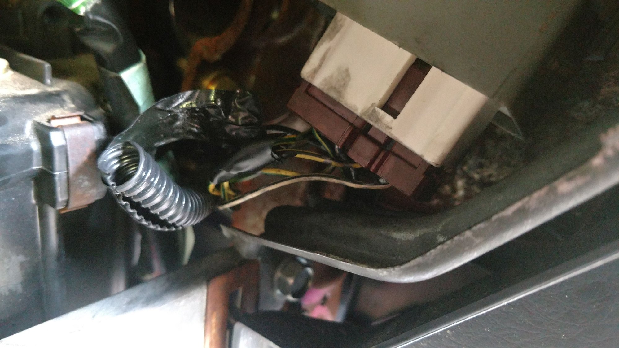

Found where the no speedo/no VTEC/rough idle problem came from. One wire was severed from the plug. The old plug was cut from the spare harness and merged onto the old wires.
Also the fuel pump issue has been fixed and the car not stopping has been fix where it was staying on constantly was fixed as well.
I took the car back to the shop and explained the situation and he forgot about the wiring on the main relay plug. He disconnected two wires or merged them. I'll take a look tomorrow and send a few pics.
SO::: SPEEDOMETER WORKS. VTEC KICKS!!!!!!! NO MORE FUEL PUMP ISSUES. NO MORE ROUGH STARTS / NEED TO THROTTLE TO GET IT WARMED UP. TURNING KEY TURNS THE DAMN CAR OFF!!!

NVturbo, believe me, he knows what he's doing. One of the owners younger guys was doing the auto to manual conversion and the owner didn't check to see if the guy did the wiring. I talked to him and he was really upset about it not being 100% the first time.
He helped me out a ton and im not gonna hold it against him.

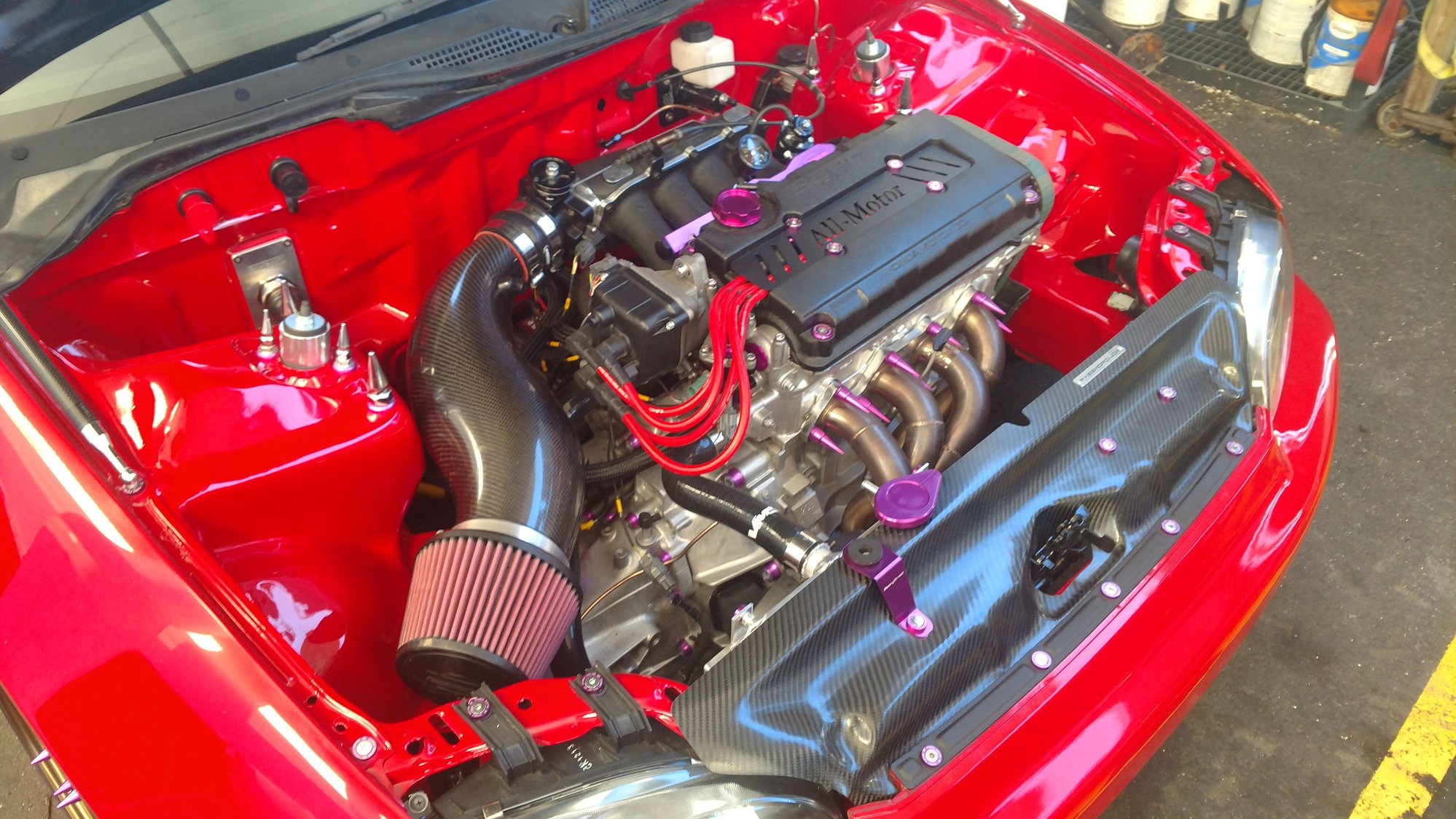

These are the owners cars. The blue EG is a real RHD import, which he Kswapped and shaved.
This is his GSR I believe
When I got there he was doing an h22 Euro-R swap into an EK Hatch. He definitely knows his stuff..

Why the **** would you even have to fix any plugs if this is an em1 engine harness?

You never need two ECUs. Did they really give it back to you with the auto ECU still bolted in and the manual one laying in the floor?
#37
Re: b20v swap (ek hatch)- WONT TURN OFF!!!
Based off the photos, they did. Still hooked up. I dont know why the OP still give these so call "pro" praised. Sloppy work at best. Proper swap would not look this way. Ive seen garage swap that look 10x better than this. OP need to raise to higher standard. This type of swap is unacceptable. Quick in, quick out. Doesnt make the shop business look good.

just for clarification, the automatic ECU is no longer in the car, nor plugged up. the car is running great now.
idk why the car didn't turn off though, or why the fuel pump didn't stop running
the VSS plug wire was messed up- I saw this first hand, which is why he wired my old plug up to it.
harness was converted to an obd1 alternator plug because I have an obd1 alternator
injectors converted to use RDX 440's
idk why the car wouldnt turn off..... I didn't get any real answers from anyone here, that I could try myself, so...
