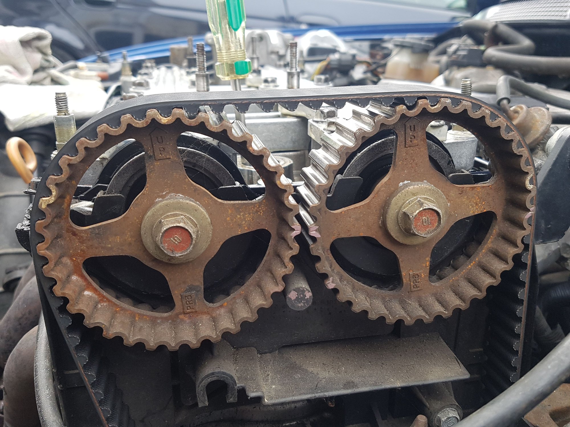

Check the physical timing yourself. Likely it has never been right since the belt was put on. This is a major reason to not rev up fully yet not throw a code either. It is not complicated to do, you only need to remove the top plastic cover and line up the marks.

Do as mk suggested -- check the mechanical timing. And post pics.

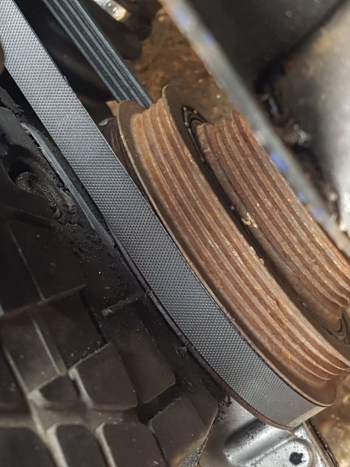

Right so new distributor is in.. the car runs well but the 4500 limp mode fuel cut still occurs
Checked the physical timing. As pictured
