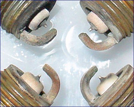

After trying different brands of sparkplugs in my DD CiViCs, I settled on Champion Copper Plus #318 (RC12MC4) years ago.
I don't know about you guys, but I use an aggressive gap (.48-.50) and Copper Plus plugs get the job done!
Don't ask me why (guess I was in a whimsical mood), but last time I changed them out, I went with NGK BKR6EGP plugs.
Here's the result, after about 25k miles (platinums are supposed to last longer)...
Does this look like 'normal' wear to you (B16A2 with approx 100k on the motor)?
Tips and grounds are okay, but the ceramic looks a little shitty to me!
I'm NOT a fan of platinum plugs, but I can glass bead them and keep 'em around... I guess.
I replaced them with Champion #318s this morning.

They look like any other plugs from my,or my friends B16a2's ( shrugs) I had odd missfiring issues using the plugs you haI though.Turned out two of them were actually cracked in half after a couple track days,so back to NGK iIwent( I use coppers though)

With the hundreds of times I have changed plugs in my cars or friends,that ONE set of Champions was the ONLY set I have ever had give me any issues..( and having it happen at 110+ on a roadcourse was the LAST place I needed this to happen)....I know well enough not to tq a plug down like a ham fisted idiot....LOL

I've been running Champion plugs for years. They ARE more fragile than other brands - no doubt about it.
Arizona Motto: **** happens!
Only ones I've busted though are ones I accidently dropped on the floor...
Do you use a torque wrench?
Flat seals are really hard to 'read', especially if your using anti-seize compound on the threads...

I'm no plug expert, but they look normal to me. Pretty good for 25,000 miles.
In the pic, the one on the bottom right looks a little white though (I bet it came out of cylinder #1 ).
The NGK Laser Platinums I used with my B16A and the V-Powers I always use otherwise with both cars I own end up with that same redish hue.
Honestly, I don't think the Platinum plugs are woth the extra money. The electrode may last a very long time, but the gap between it and the strap will still increase over time. I hate the idea of pulling the expensive plugs, re-gapping them and reusing them.

Honestly, I don't think the Platinum plugs are worth the extra money. The electrode may last a very long time, but the gap between it and the strap will still increase over time.
Agreed!
Plats are okay, if (say) you got a V-6 minivan and have to remove the intake manifold to service the rear plugs - or whatever.
Generally speaking, I don't care for platinum-tipped plugs, but they do take a beating!
Silver plugs are the best IMHO... but like you said, I don't think they're worth the price ($15 each for Brisks).
Copper core plugs have always worked best for me, and they're cheap enough to replace at every oil change, if you want.
I paid 2 bucks each for the Champion #318s, but I've bought them for as little as 79 cents in the past. LoL!
Guess I'll stock up next time I see them on sale...
