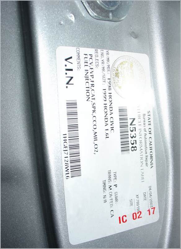

2) Ref/BAR?!?!?
Originally Posted by kurtiis
I just need a car to get me from point A to point B RELIABLY [...]
3) Check the date on the Ref/BAR sticker. Still running great after 6 years @ 8000+ RPM!!!
