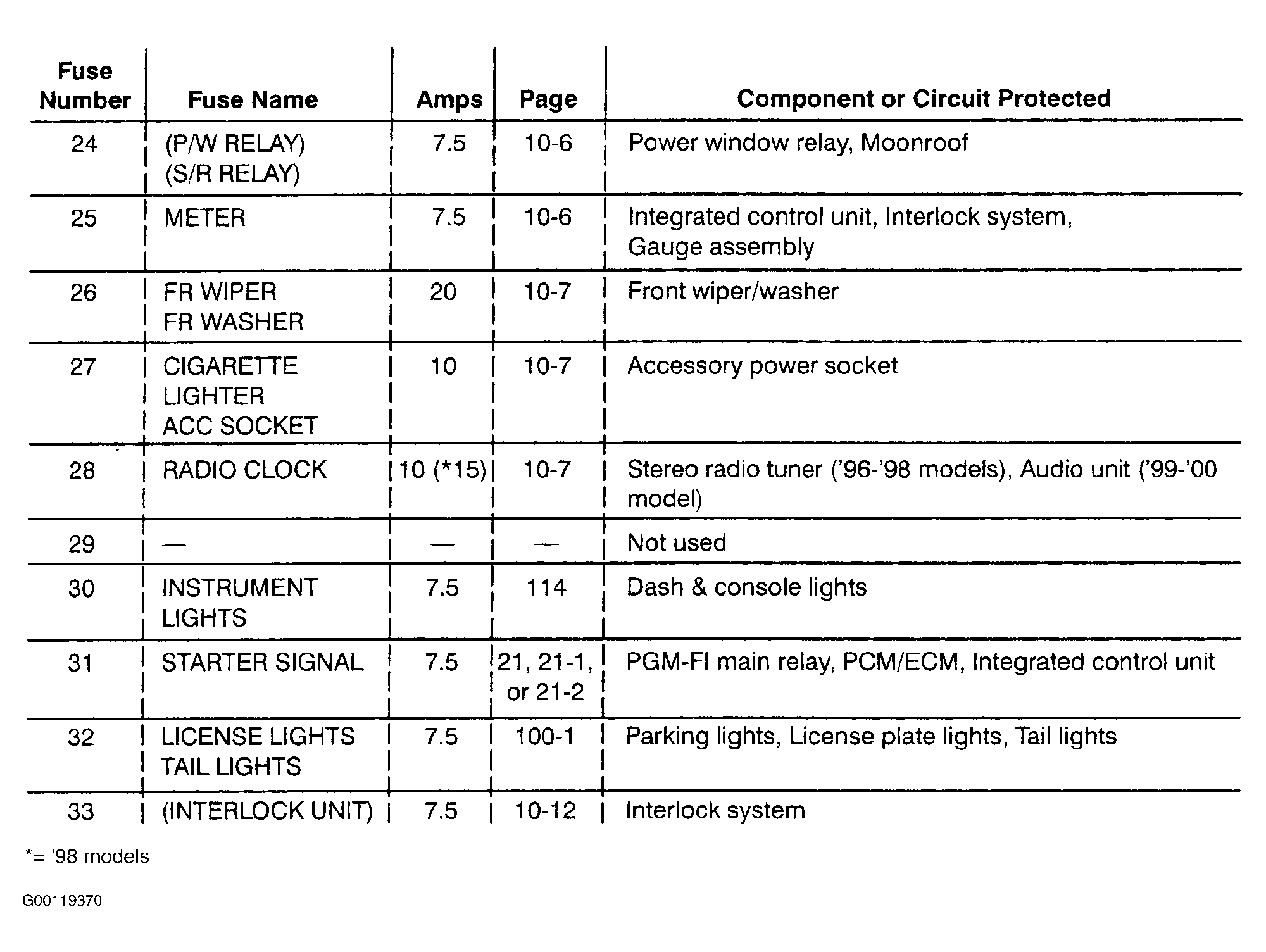

The fuse block under the drivers side of the dash, just above the pedals? I pulled some of those fused jumper wires someone added to power something else. Before snapping some better pictures so I'm not sure what ports the main fuses in these jumper wires were in or what they went to, or even if they were actively used factory ports. Strangely 1 of the wires was plugged into another port.
This sort of crap, there were 3 of them... Going to go out to the car in a few minutes and see if I can find anything that doesn't work now...

Year make and model?

98 Honda Civic HX 5 speed.

Let me know if that's not what you were looking for.

That at a glance (at work) appears to be exactly what I was looking for, thank you!
