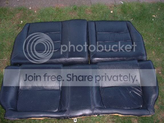

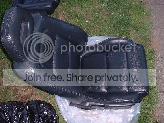

Im interested in buying these G2 Integra Leather seats off a guy from a local forum. I was just wondering if anyone else with a EG has ever put in front, and mainly the rear seats with no problems. Or if anyone knows if they will fit right in with no problems. Also, any pics of people with these seats in there EGs would be sweet. Thanks.

yes, you can put the front seats in your car. not sure about the rear.

as you can clearly see with the rears those are 60/40 split seats and i beleive civics are 50/50 splt seats. so you will have a problem with that.

i'm pretty sure it can be done.
i remeber one that was done a while ago here, and the rears fit almost perfect.
just a samll gap at the side's....

The top is a DC seat (ITR to be exact but samething as a GSR and LS) and the bottom is a DA seat. You need to be more specific on whether you're putting the seats into a coupe or a hatchback since it's a different fit in the rear. The fronts, the EG/DC seat rails are spaced further apart (I believe about 17.5" from each other) and the DA seat rails are closer (around 16-16.5" from each other). Therefore, you either have to swap the pans on the front seats or redrill and tap/thread some new holes for the Civic...... or just bend the **** out of the rails and make it fit.

IT FITS!
All you have to do is drop the seats in there and you will see there isnt much modification. (atleast in my hatch) Mine are itr seats.

I had da's in my eg hatch before. In my experience, for the front, 3-out-of 4 slider bolt lined up. The rear, closest to the e-brake, did not. After about 3 months, I had to get the eg sliders.
The rear also caused a slight problem...
<TABLE WIDTH="90%" CELLSPACING=0 CELLPADDING=0 ALIGN=CENTER><TR><TD>Quote, originally posted by NextelBuddy &raquo;</TD></TR><TR><TD CLASS="quote">as you can clearly see with the rears those are 60/40 split seats and i beleive civics are 50/50 splt seats. so you will have a problem with that.</TD></TR></TABLE>
