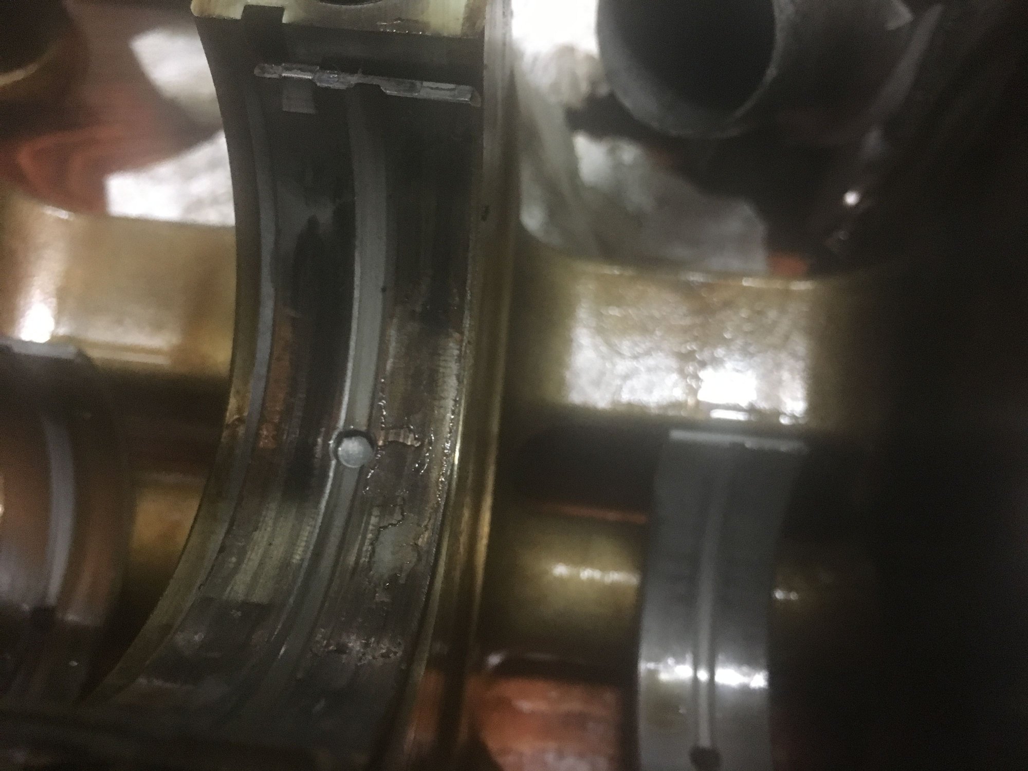

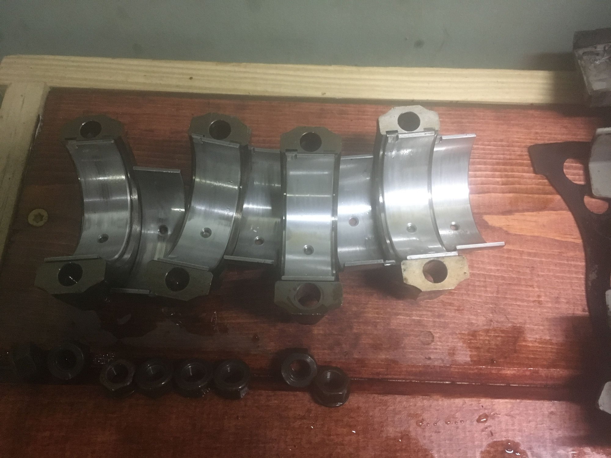

Hey there honda-techies. So it's been just about a year since i rebuilt my d16y8 and i have it torn apart again. I sucked up a bit of water in my cold air intake and since then the car has misfired at idle (flashing cel) when its cold and then just reeks of gas when warm. I did a compression test and cylinder one was ~100 while the others were ~195 psi. pulled the engine apart and found a good bit of shavings in the oil pan. all the rod bearings look new still but i took off the girdle this time and found that the shavings came from 2 of the main bearings. what my question is, did the water cause the main bearing damage? or did it possibly blow my head gasket out on cylinder 1? rods still look straight and pistons/rings look fine. same with the headgasket. I couldn't see any obvious signs of a blowout. car didn't smoke at all just was dumping gas on cylinder 1. i plan on ordering some main bearings and main bolts then slapping it all back together. let me know what you guys think.
Thanks.
shavings from oil pan
rod bearings still look new
