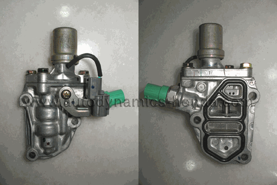

Originally Posted by 99sohczc
Vtec solinoid missing but working on getting one as to have it wired...
Your VTEC solenoid isn't missing. It's the oil pressure switch that is.
The green plug pictured below is the oil pressure switch. It's part of the VTEC solenoid.
eH.

[QUOTE=eHMxhACk;50743399]Your VTEC solenoid isn't missing. It's the oil pressure switch that is.
Oo right... Thankx... My bad the one that comes out of the block is also missing. other than that everything is good, just wanna know why isnt it turning on...
