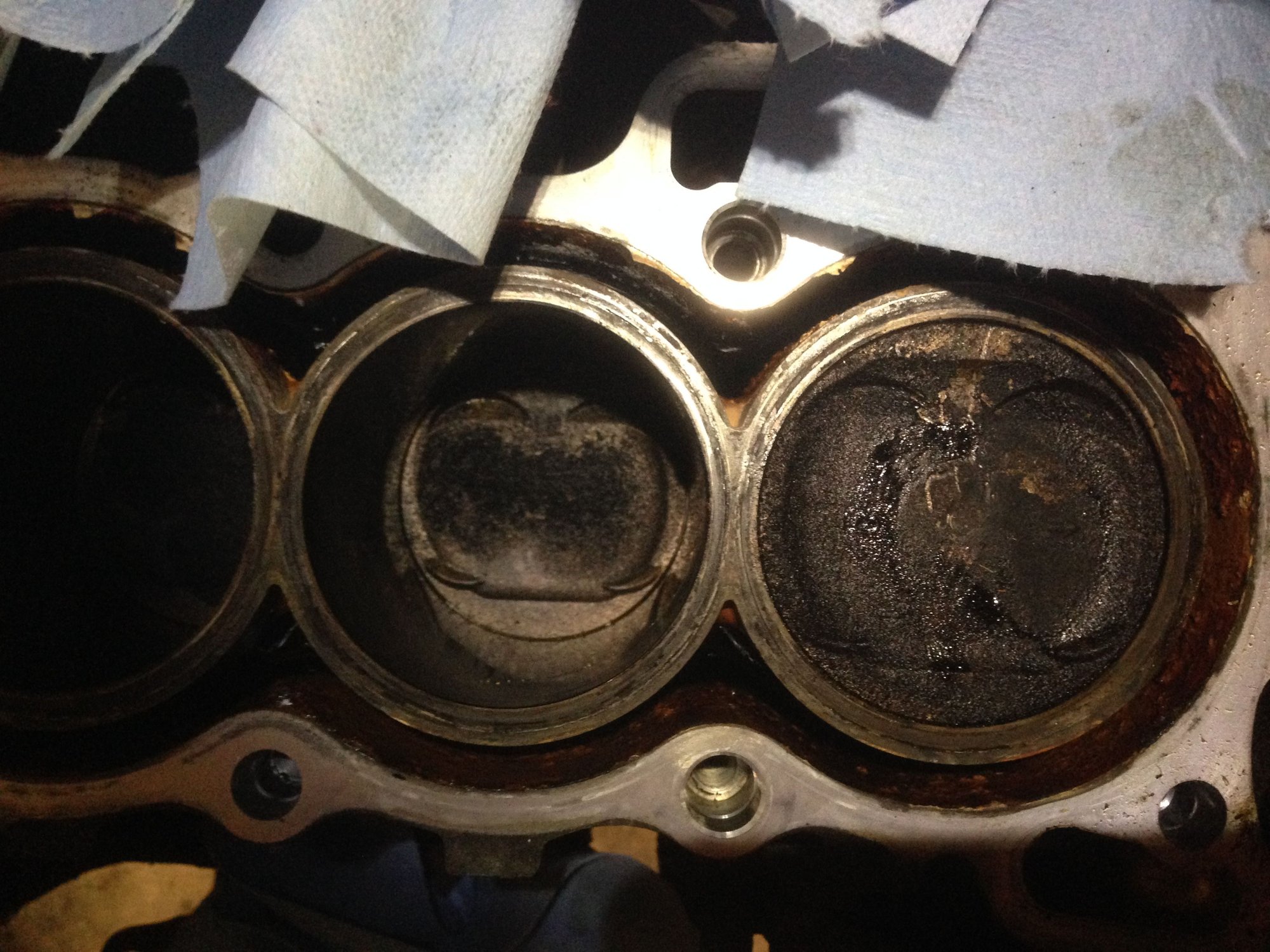

Check it out I finally removed my head...
I need to know the fill-gap size for max amount of gap for both block and cylinderhead.
another big issue...
rust and residue
there is rust in my block and the cylinderhead.
is it bad to the point i shouldn't work on it?

I would suggest downloading the FSM, it has the information you need on how much you can take off before the head can no longer be used.
You can take the head to a machine shop to clean up and reassemble

Examining the old head gasket is usually the best clue to where it blew out. The "fire ring" area is the most critical.
Is that missing metal at the intake side of #3 or just some black gunk?
And yes the cooling system is really crudded up.

I'm betting someone left the block exposed to the weather...like outside in the rain with the hood open.

See all that build up on the wall? God damn.

take it or ship it to a reputable shop to have them clean the block
